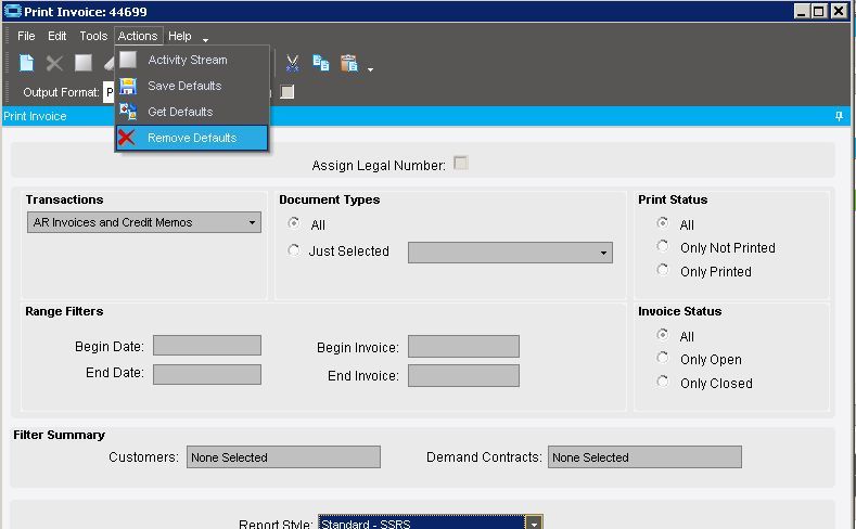

In the print invoice screen, click on actions – remove defaults. Close out and then try again – see if that helps
[invprint.jpg]
I seem to recall something like this happening in E9 once. As I recall, it was somehow related to the user saving default values within the Print Invoices form. Somehow it gets a specific invoice saved in those defaults and then every time you print, that’s the invoice you get. Try a Remove Defaults before you print next time and see if that helps.
Trying “Remove defaults” had no effect.
And I’ had already purged personalizations related to AR Invoice.
Also worthy noting, the problem exists regardless of Report style or RDD.
Calvin
I spoke too soon.
I hadn’t closed the Print Dialog window, after removing defaults.
Removed defaults, closed window and then tried printing again.
SUCCESS !!!
