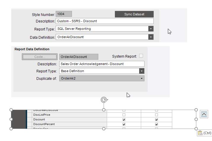

I am trying to add a field into a custom report but whenever I do, I get an error. I have only done this once before so it’s possible I am missing something obvious…
Steps I have taken:
Made a copy of an existing RDD and linked it to a new Report Style
-Report runs fine at this point
Went into RDD and unchecked the Discount field from being excluded. I tried just deselecting the column name and then both the column name and label.
-I try to re-run the report with the previous GUID created and I get the following error:>

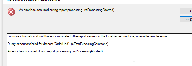

Did you add the field into the actual ssrs report query after including and saving on the report data def?
I just tried adding the field into the query on the actual SSRS after unchecking and saving, but got a new error
image when trying to view in SSRS and the same error when trying to run through Epicor.
Can you extract the ssrs query and run it against the report database? I think you’re gonna have to start with something that works and add to it slowly to see where it’s failing
