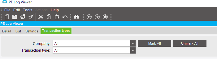

@LBARKER
Check in PE log viewer may be some transaction types PE log is enabled.
General Ledger → General Operation → PE log viewer
Navigate to Tran types and check.
PE log is company dependent.

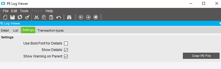

Clear the log and the Disable the PE log

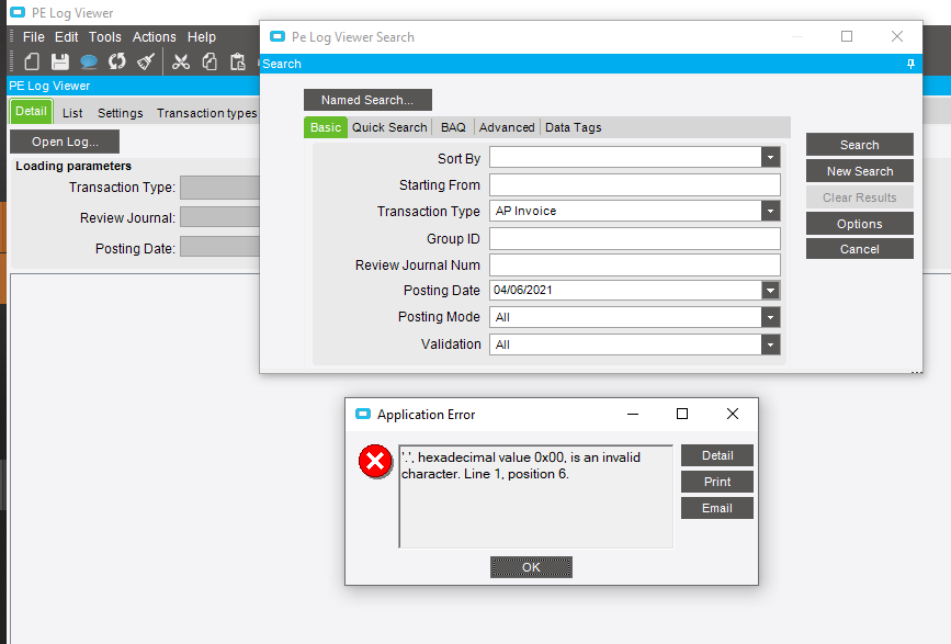

I get this error

@LBARKER
Do not search.
Step 1
Navigate to Transaction type, from the logging column, filter for Value “True” and uncheck.
Step2
Click on clear log.
