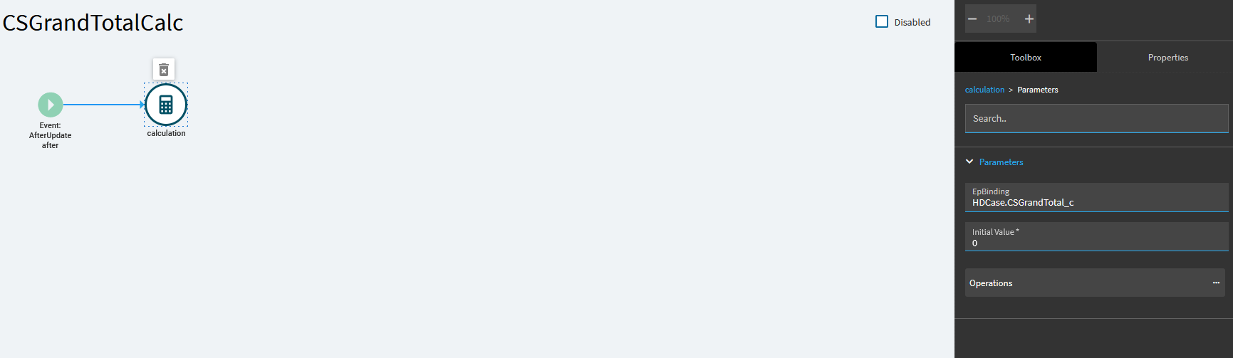

Good Morning! I’m looking to do a grand total field that just sums up values from other fields below is what i have… though its not working am i doing this wrong?
Below SS of my fields… the Grand Total is what I’m wanting the event to populate.
Here is the event set to fire after update… i think this is the one i want to be using?

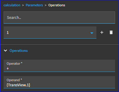

Here is what the Operations look like… one for each of the 5 fields.

Try throwing curly brackets around your Operands: { }
That’s how you get the “value” of those bindings.

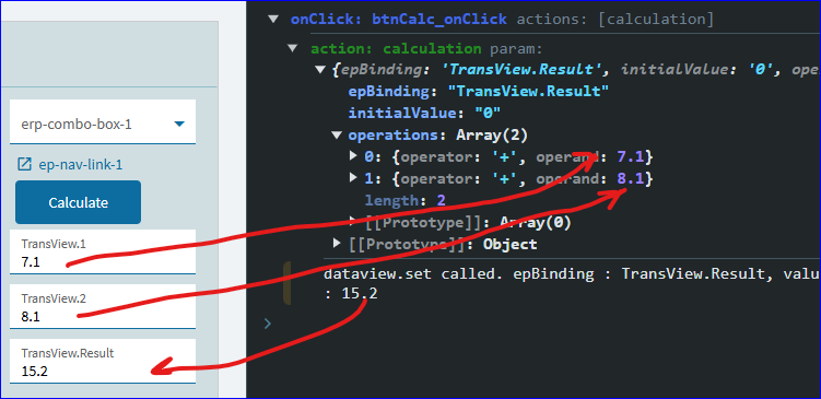

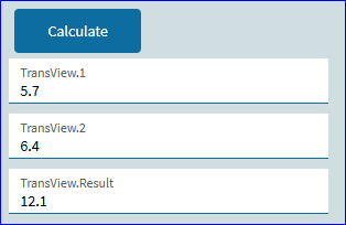

Worked for me.
Calculation settings:
Operations:
Fields on my form… I used a button to trigger.
Correct. The EpBinding on the calculation widget is where the value should end up. No reason for a row update.

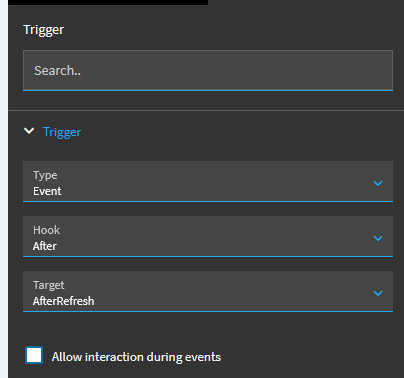

Humm maybe its on the event fire then… i had it after refresh.
Really i would just want this to fire when a save is made… not on button click… what hook would you recommend?

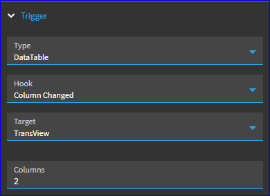

If it were me (and this is more work, but may present nicer).
Take the Calculation event you have and set it to No Trigger (delete all the settings).
Then, create an OnChange event for each of your user-entry number fields.
Again, a pain to set up (repetitive)… but now my “results” get recalculated any time you update any of the entry fields.

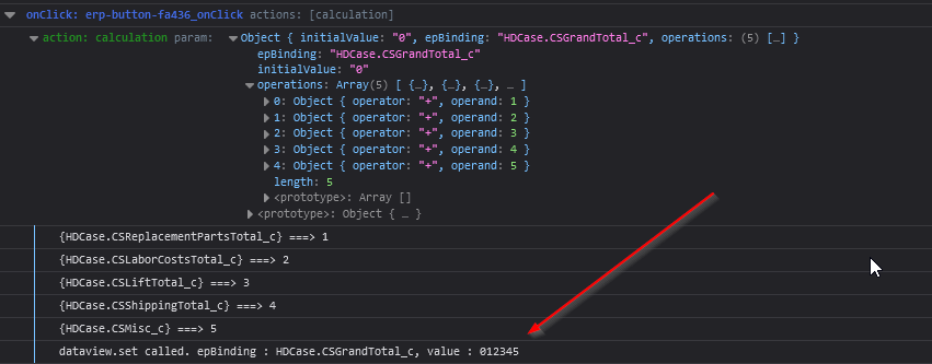

so i change to a button to test… but its treating my fields as a string and i cant find out way.
Console.
Database.
it really feels like Epicor is trying to drive me crazy today.

Show me your calculation again… with one of your operands.
You didn’t wrap those in quotes, did you? Because that will tell it to treat it like a string.

And looking at my previous debugging image vs yours… my operators are in single quotes… yours are in double quotes:
Mine:
Yours:
So… we may need to find out what’s going on there.
The calculation is RUNNING… so that’s good. It’s just concatenating a string instead of performing a calculation.

I think thats just because i was debugging in firefox… and firefox be firefox.
Chrome shows how you see.
Im on 2024.1.11 so maybe it is the case… sigh i have a sandbox with the latest i guess i can try in that tomorrow at this point i think i need to walk away.
