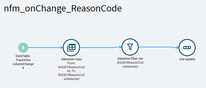

Then, here’s my event…
When I make a selection in my combobox (bound to TransView.ReasonCode), I need my event to fire. So I use a trigger of Data Table, Column Changed, TransView, ReasonCode
I then perform a dataview-copy… I copy my BAQDVReasonCodes dataview to my new dataview BAQDVReasonCodesSelected.
I then filter THAT dataview:
Now, the only row in my dataview is where my selected TransView.ReasonCode value matches the Reason_ReasonCode value in my BAQDVReasonCodesSelected dataview.
I then perform a row-update to set TransView.Reason_Description to the value of BAQDVReasonCodesSelected.Reason_Description.

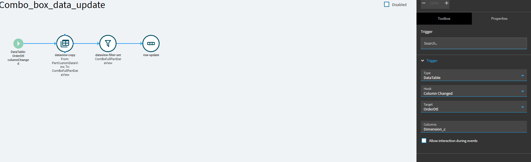

for the filter field, I am confused how you got Reason_Reasoncode
Is this correct as the trigger since the drop down is bound to orderdtl.dimension_c?
Reason_ReasonCode is just a column in my BAQ.
My BAQ Dataview was BAQDVReasonCodesSelected.
I wanted the filter to find the row where Reason_ReasonCode = my transview column value.
Yes, that looks correct.
But I noticed in the developer tool that nothing fires
and this is my row update properties

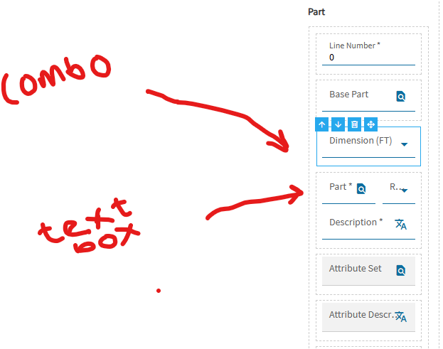

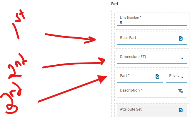

Can you show the bindings of all (3) of your controls?
Base Part (Textbox/Search)
Dimensions ComboBox
Part Search
Base Part
Dimension
PartNum

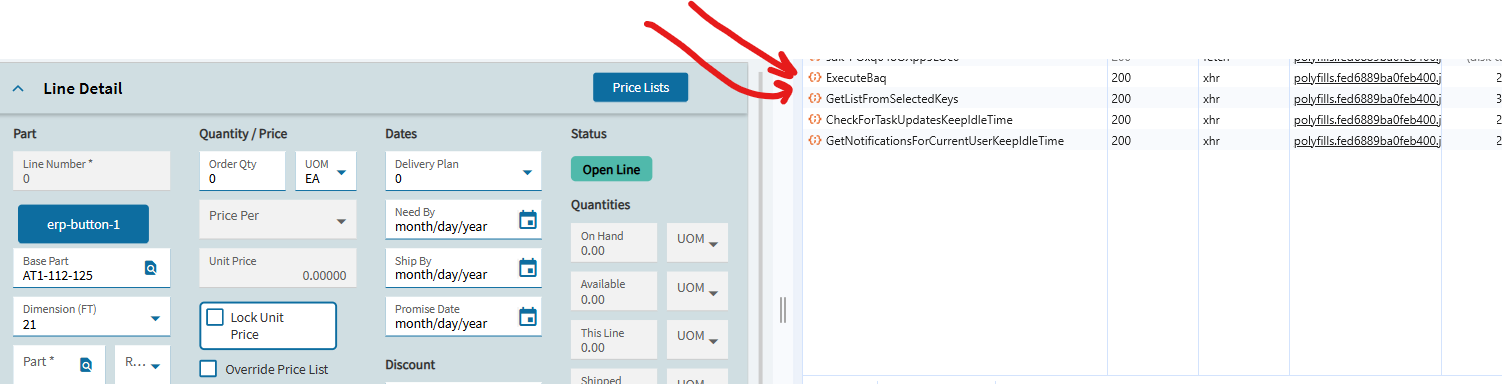

Yes boss, so you see the BAQ for the BasePart and also the dimension is populated accordingly and after that, no fire ups again.
I am suspecting if we need to change the event trigger

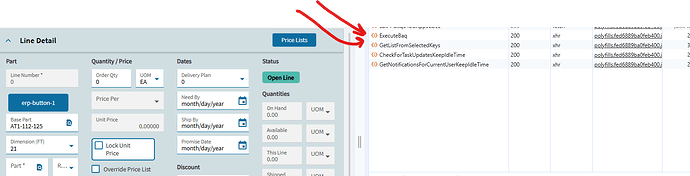

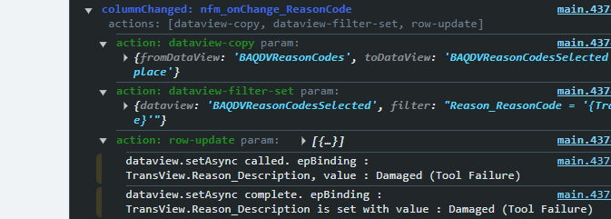

You may not see it in the Network tab of debugger. The event is doing work locally, not sending/receiving with the server. Can you see your event firing in the Console tab?
Here is mine firing, as an example:
Nothing is firing in the console Tab
