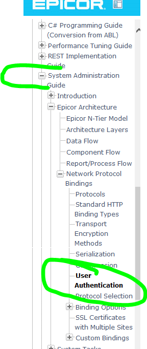

Does Epicor support SAML 2.0?
As of this time, no announcement on any other User Authentication mechanisms. Epicor User/password and MS Windows Auth.
There are tools out in the wild to convert SAML to WIndows Auth but none I have seen tried with Epicor ERP.
