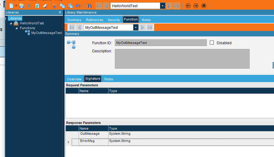

Functions are server-side like BPMS. You can design in classic, and the logic will apply to the web screens. You will need to use App studio to call functions if you need to do something on a button click, specific ui event/trigger etc.
I have some functions in a library called Conversion. I do not know how to access them in my button click event.

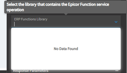

Not sure what I am doing wrong or if we don’t have something set up correctly in our Test environment.

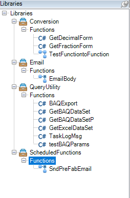

I have the following function library’s in our system.
None of them show up in the drop down for ERP Functions Library
If there is more reading I need to do please enlighten me, I will be glad to do the research.
Thanks for the help!

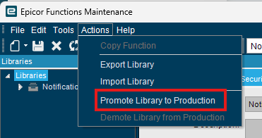

Are your libraries published? They have to be for the front end to know they are available for use.
No Idea, Guess I need to do more reading. Thanks!!!
