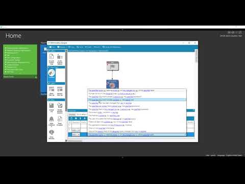

Example Video: Using BPMs to Default Values on a new part
In this video I use BPMs to set some default values on a new part in Epicor. Using both Method Directives and Data Directives I default parts per container, backflush and primary bin.
The question was posted on the EUG form, but since I made the video I thought I would post it here too.

Defaulting the part values are done in the method directive. The PartPlant and PlantWhse records don’t exist until the part record is saved the first time so there isn’t anything to update. It could be done using only method directives with a post process on Update looking to see if a new record was created then modifying the data and doing second update.
