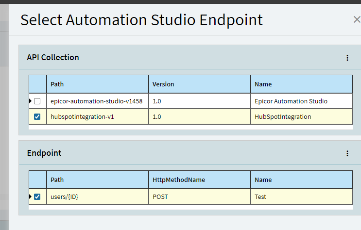

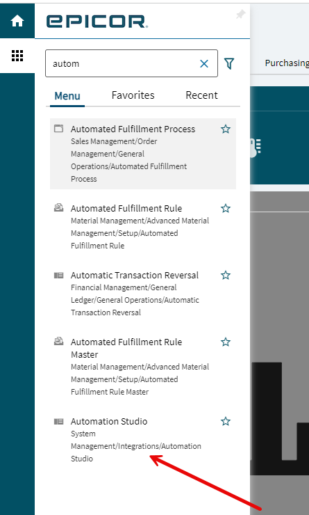

You can’t use this little fella?
undefined
That little fella is giving me some grief i may need some examples on how to setup an endpoint it is taking some time but i am figuring it out. Thanks for the suggestion.

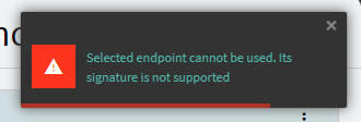

Getting an error saying signature is not supported.
You have to make sure your workato is connected to your Epicor instance. In here, then it should be setup.
I have it setup there and have it working in a update BPM but getting an error message saying my signature is invalid.

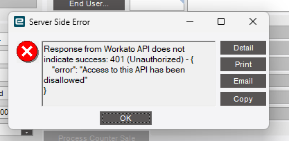

I have been able to get past this last error but now i am receiving this error now. Can anyone shed some light on what i need to do in workato.
Everyone thanks for the help i have been able to get everything to work from a bpm with out issue. Took some trial and error.

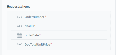

This error was related to how i was configuring the API in workato. I was able to do that by filling out the Request schema. Once that was done i was cooking with gas.
this error was related to
I needed to make sure the end point was under a working client.
