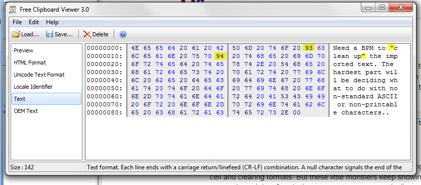

FWIW - I use a tool called Fee Clipboard Viewer 3.0 to examine text for irregularities.
For example in the text below (copied from a post above)
shows that the quotation marks are actually non-standard ASCII
(highlighting mine)

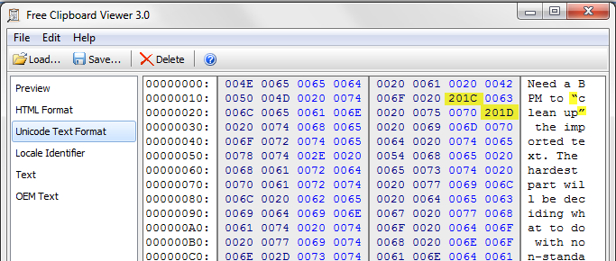

Looking at the clipboard from various formats, can reveal more info.
When i examaine the same text as Unicode, it shows different values for those fancy quotation marks.

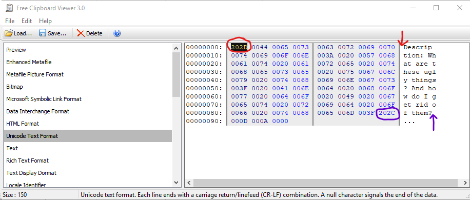

Pretty Cool! Thank you @ckrusen for recommending this program.
This is what I found…
My search results say that the 202D is a Left-To-Right Override and 202C is a Pop Directional Formatting character.
Ok, so now that I can see the hidden Unicode characters I guess the next step is to try and develop a macro to search for and eliminate them…? I’ll have to check with my Excel guru on that one.
