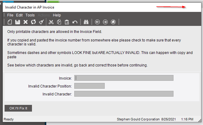

You could try to hide the ControlBox on the customization to the BPM Form
IP_InvalidCharacterForm.ControlBox=false;
