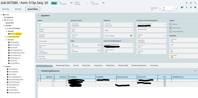

Hi @LarsonSolutions , thanks for the reply! I am attaching the test job we created which hopefully helps illustrate producing a quantity on OP 10 and not fully consuming it on OP 20 before completing the job. Material 110 is the material on the phantom BOM consumed on OP 10 (all our materials are set to backflush - you are correct), and the rest of the materials required to complete the finished part are associated to OP 20.
In reality, the materials consumed on Op 10 create a Subcomponent that we can put to stock if for whatever reason we do not complete the quantity required on OP 20. In this case, the tester produced 270 units at Op 10 (1st screenshot), but only reported 180 units of the finished good on op 20 (2nd screenshot).
My question was to determine if/how to put the remaining parts molded in OP 10 to stock, if for some reason we needed to end the job prior to them being consumed on OP 20. In this case, the balance 90 units of materials that exist in limbo on Op 10 are no longer their original material of h ppo black - they are a molded part that we ideally would like to stock under the part that holds the phantom BOM (part 4060001 in the 3rd screenshot).
I’m also confused as to where to see the WIP balance, as when I check it on the job, the WIP Part and Material locations, it’s empty, but I do see the fully issued stk-mtl value in Mtl Transactions.
Last note: Screenshots are from testing completed in 2024.1.19 test enviro.
Screenshot of Op 10:
Screenshot of Op 20:
Screenshot of the Part with the Phantom BOM represented as Material 110:
