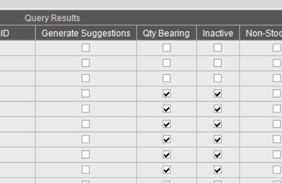

I am making a report that shows the status of each part in BAQ. I want to show except for the inactive parts. Is it correct to set in Table criteria? How do I set it up?
Thank you in advance.
Even though I set it like that, Inactive Parts keep appearing.
Is there anything additional I need to set up?

I changed the condition constant in the parts table from false to 0, but still Inactive Part appears.
