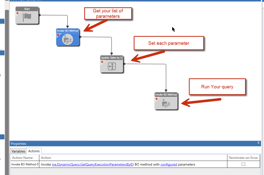

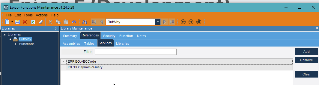

You can do it with widgets in a function. You need to add the service to the function so you can get to the BO. Then you’ll get paramaters by ID, set the results to a queryexecutiondataset variable that you create. Then you set a field by query, where you set each of your parameters in the dataaset, then you call you BAQ with GetListByID. You’ll make a table variable for the results, then you do what you want with it from there.
But, like others have mentioned, you can do the updates that you want in an updateable BAQ, so making a function for this is mostly pointless unless there is more information to the story that you haven’t shared. You can just run “BAQ Export” process to just run the BAQ, or slap it on a dashboard to run it.
