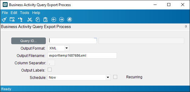

I made my BAQ updateable and created a post process on the GetList and am now able to run code. I dont think i need to do the BAQ Report, i can run a BAQ export on the BAQ and schedule that. I have this on some other BAQs but they actually need to update the BAQ.

But anything you can schedule should be fine.
I was going to say
ā€œYou can just use a Dynamic Report instead of a BAQ report. (i.e. create a RDD and add a BAQ to it, then create a new report style).ā€ but reread. You are sending to an external API.

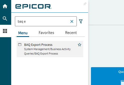

In your circumstance I would be going with the UBAQ and sending to the REST API directly from there and use the Export BAQ Process. That way you would have a copy of what was sent to the REST API. I would go as far log it to a UD table.
@klincecum Yes it still exists 2024.1
Answering my own question with a little egg on my face.
Still there today, and now I remember I have used it. :rofl:
