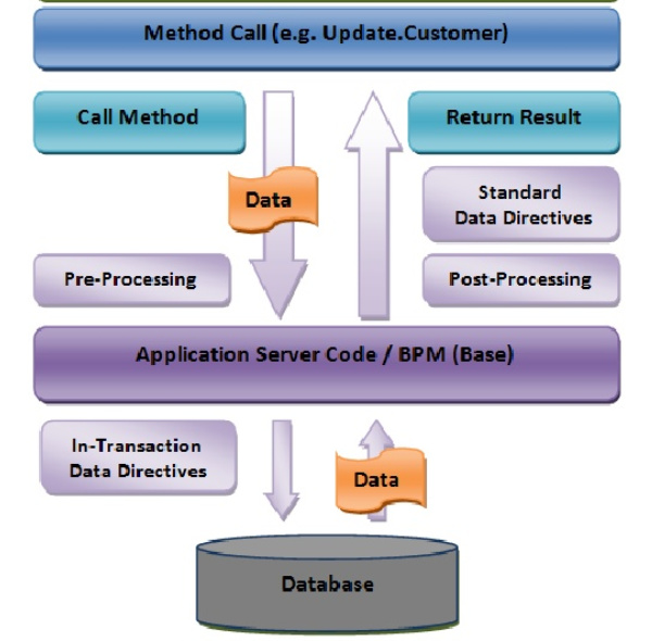

Do data directives always execute after method directives? I’ve setup a data directive that checks for certain conditions in the data, but they depend on data that is modified through a method directive. I’ve looked through some of Epicor 10’s PDF guides, but I can’t find a clear answer.
We use this visual in some of our training. I believe it is also included in some Epicor documentation.Let me know if this answers your question or I can explain further.
Ok - so Standard Data Directives run after the Post-Processing method directives?
That is correct.
That’s what I needed to know. Thank you!
