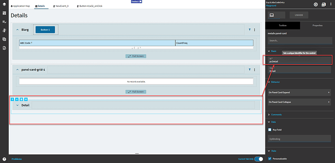

Buuuut, if I recall, you can use the property-set widget, enter the panel ID or whatever it needs, then set the “expanded” property to true.
I did my example on a button click, but you can use whatever event you need.
ExpandPanel

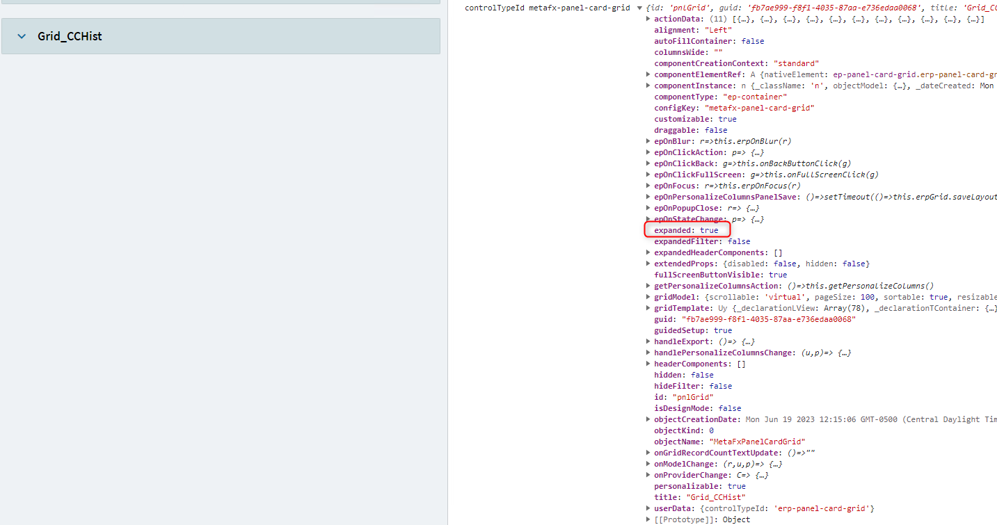

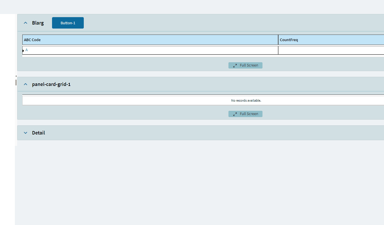

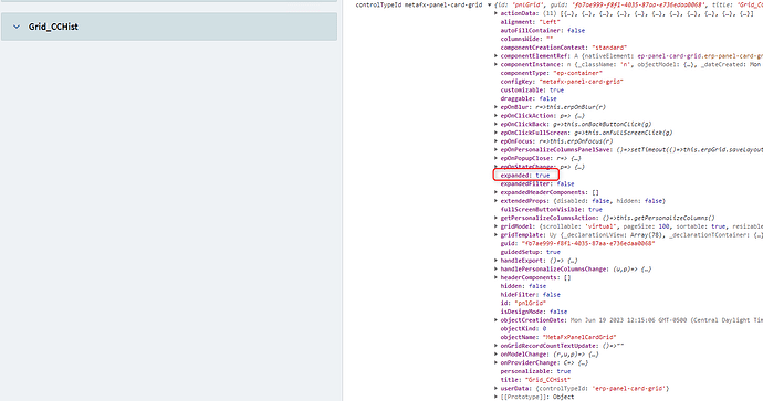

Am I going crazy or is this only working for normal Panel cards currently (2023.1.4)? Trying to expand a grid panel and the property-set is setting the flag to true, but not actually expanding. Tried with a normal panel card and that expanded without issue. Tried setting expanded to false when it was open and same thing where it sets it, but doesn’t do anything.
:thinking:
Yeah–I can’t get it seem to work on a panel card grid either.

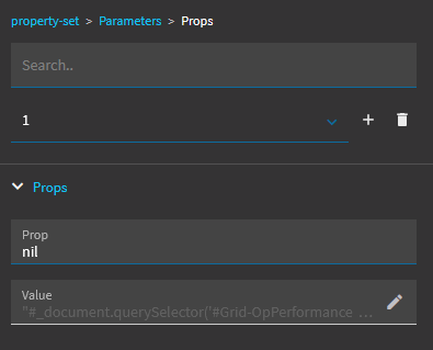

For my scrolling issue specifically, my super hacky way to a better UX is by using property-set to execute some simple Javascript to scroll the table div to the top. It seems to work great! This could probably be made more robust by searching the grid containers children for a div CSS overflow set.
The actual property value:
"#_document.querySelector('#Grid-OpPerformance .k-grid-content.k-virtual-content').scrollTop = 0_#"
Swap #Grid-OpPerformance for the ID of your grid.
