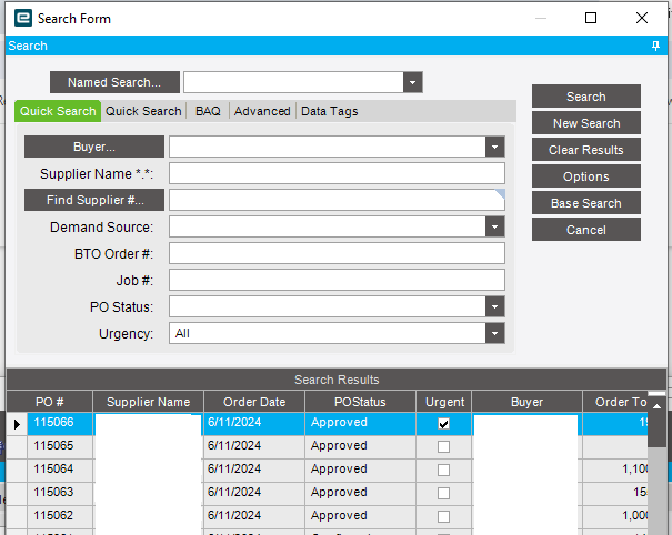

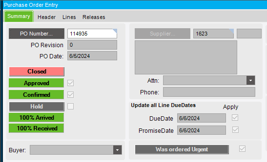

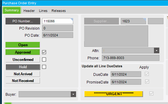

We added an Urgent field to on our PO header, customized PO screen, PO report form, and some dashboards / search screen to show it.
