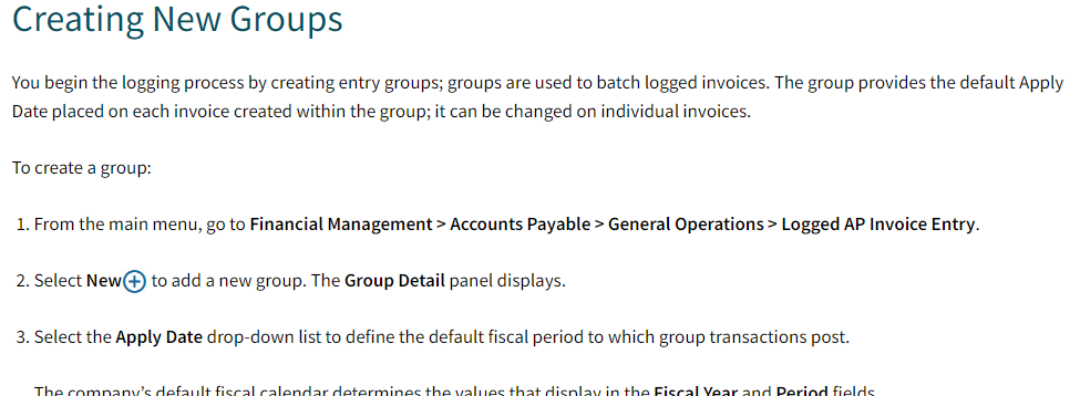

Have you looked into the Logged Invoices functionality? If you are not going to be creating POs, I recommend that as it allows the Invoice to be entered and then approved.

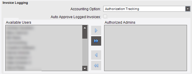

You don’t need access to the financial modules for this. Approvers are set up at Company Configuration.
True. I’ve never thought about having non-finance people enter an AP Invoice though… I guess I could deploy ‘Logged AP Invoice Entry’ to their menu folder. Looking at the instructions, there’s a lot of stuff the construction guys won’t be comfortable entering, if they have to create their own AP Invoices. They’d need something minimal - like Date, Description, Category, $, (Vendor), and maybe a link to an order, job, or project.
No, you would have accounting enter the Logged Invoice and then it needs to be approved by one of the Logged Invoice approvers. All you would be asking employees outside of accounting to do is go into Logged Invoice Approve and Void Entry and approve the Invoice for payment.
