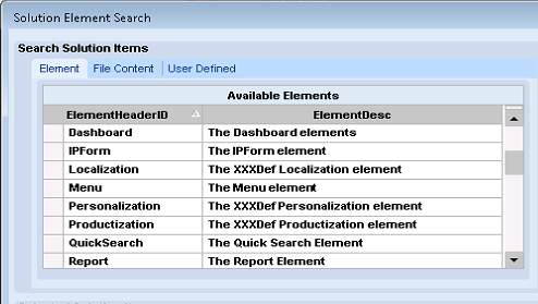

Henry,
See if Solution Workbench will do what you’re looking for.
Joe
