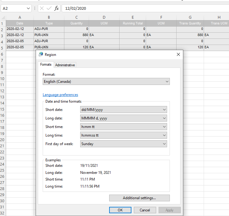

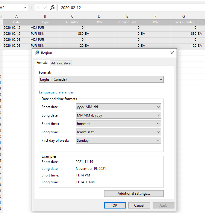

Go to Control Panel and the Region
There change the time format to whatever you want.
It will automatically change it as soon as you change the format and click on Apply button:

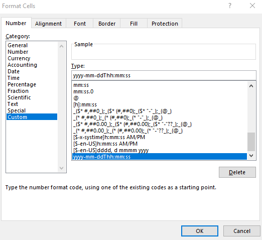

I just came across this. Format your cells to custom with the type as per the screen below. After that, you can reformat them into XX/XX/XXXX. Happy days.
