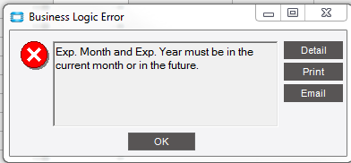

Expr. Month and Exp. Year must be in the current month or in the future
When we do cash receipt entry, we got the following Business Logic Error for some customers. Anyone knows and can help how to deal with it? Thanks.
You usually get that error if you have a Credit Card record for Customer with a Year in the past. So make sure their Credit Card on file Expiration Month and Year are not expired (old). The method that usually invokes that error is the ValidateCreditCard method.
