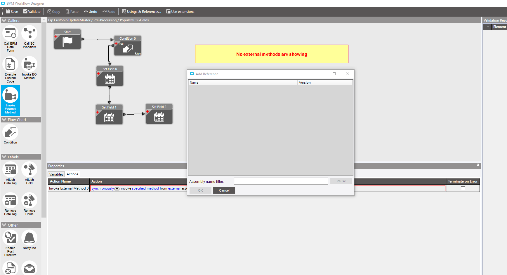

Hi,
Has anyone seen this issue before? In the BPM designer when adding Invoke External Method, it shows up blank. There should be about 20 listed. I double-checked the web.config and it is pointing to the correct folder that holds the externals. Also checked permissions on that folder.
try recycling IIS
For what its worth. It looks like it was an issue with a corrupt dll in that folder causing the whole thing to go south. It was put there via Solution Workbench and must have gotten corrupt somewhere in that process. Once I copied it manually, recycling the app pool the list showed up again.
