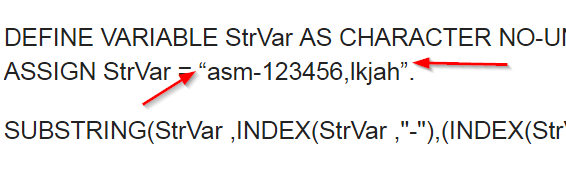

DEFINE VARIABLE StrVar AS CHARACTER NO-UNDO.
ASSIGN StrVar = “asm-123456,lkjah”.
SUBSTRING(StrVar ,INDEX(StrVar ,“-”),(INDEX(StrVar ,“-”)-INDEX(StrVar ,“,”))).
I’m trying this but Epicor isn’t liking something in the substring… Unfortunately it doesn’t tell just what it doesn’t like.
I hope you’re not copying and pasting Simon’s code - because some of the quotes are fancy open and close quotes

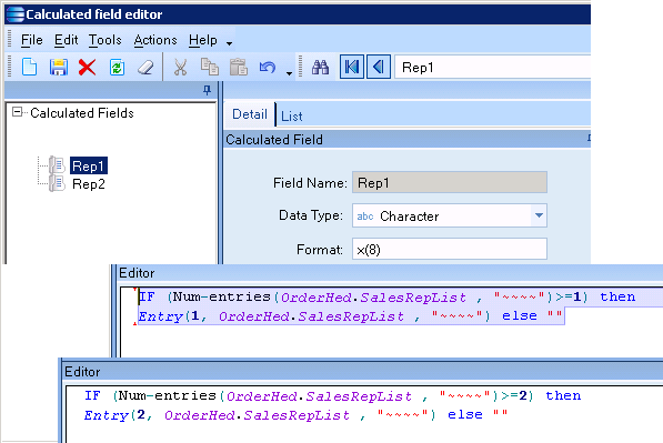

There are three functions that Epicor uses to parse out delimited strings:
Num-entries(list, separator)
Entry(expression, list, separator)
Lookup(expression, list, separator)
where list is your string and separator is your delimiter. Expression is either a string or integer. In your string:
str = “6’28635~7’28635~8’28635”
num-entries(str, “~”) would return 3. There are three substrings delimited by the “~”.
entry(2, str, “~”) would return “7`28635”
lookup(“8`28635”, str, “~”) would return 3, the third entry.
In this case, you would first split by "~’ and then split those by the “`” grave.
Mark W.
