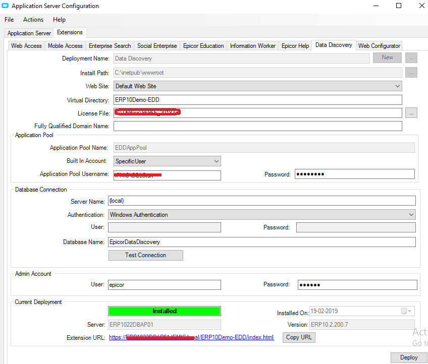

Can you please assist this. I am running epicor 10.2.200.12
I am trying to install the Epicor Data Discovery, below are the options I have put, most are default anyway
When I click deploy, I get an error that says “Failed to install Epicor Data Discovery”. The event log does not provide any useful info, it just says Epicor Data Discovery failed

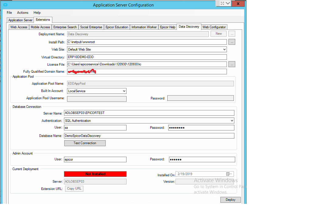

Please use custom account instead of local Services for application pool

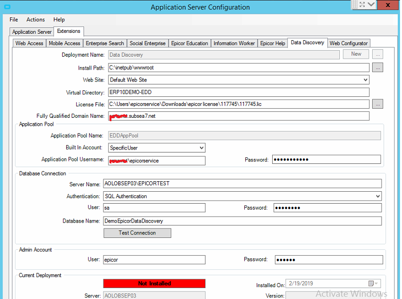

Hi Sanjeev
I have put a domain account for application pool but still the same error persists.

Looks like you got it installed. You can review the log file it generates in the following path:
…ERP10\ERP10.2.200.xx\SupplementalInstalls\Data Discovery
In my own personal experience, EDD usually does not install correctly because of some kind of Permissions/Authenication issue on the IIS-side.
Yes, and its working fine

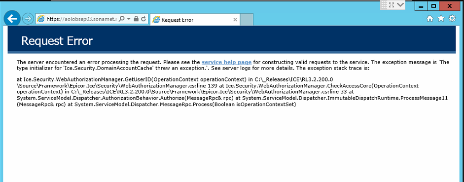

Hi Willetta
I have changed the webHttpBinding section in the web.config file from None to Windows but still can’t get EDD to install.
I have also edited the anonymous authentication credentials to Application pool identity. After typing the url in internet browser
https://FullyQualifiedDomain/InstanceName/TokenResource.svc/
I get the following error;

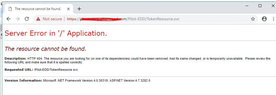

Did you try this?
I don’t have it installed but tried it none the less and it says that the site can’t be reached.
when I try to use the app server url instead of the FQDN and the instance name instead of the app server it displays this page:

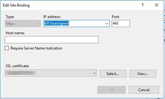

So I was suffering from problems during the Validation phase of the deployment with a “Installer has detected SSL/TLS vulnerability.” And messages mentioned in the last post.
I ended up creating a new Self signed certificate, and set it up in the binding of the website in IIS. as below
Once I had done that and made sure the SSL Domain Name matched the Subject Alternative Name in the certificate that I applied to the website. Ideally I want to use our wildcard certificate, but testing that will have to wait.
Once all that was fixed it worked. One thing during my troubleshooting, I noticed if I used the same application pool as the app server it would fail as well. I suspect because the app pool gets shut down during the install process (this gave me token errors).

Hi, I am trying to deploy a new instance of Data Discovery in Epicor Kinetic. I followed all the steps and configured everything as shown in the screenshots below. After completing the deployment, there were no errors in the “Deployment Status” window, and it showed “Application Server Setup Completed” with a green bar.
However, in the “Current Deployment” section at the bottom of the configuration window, the status still shows “Not Installed” in red, and no version is displayed.
Can someone help me understand why the status is still showing as “Not Installed” even though the deployment appeared to complete successfully? How can I ensure that Data Discovery is correctly deployed?
Is the Deploy operation supposed to be executed in the Application Server Configuration (as shown in the screenshots), or should it be done from a different place within the Epicor Kinetic Administration Console? I just want to confirm if I am deploying from the correct screen.
Is there a separate download required for Epicor Data Discovery to enable the Chart View functionality in Kinetic? I want to make sure that my Kinetic environment includes Chart View, but I am unsure if there is something additional that I need to install apart from the deployment settings.
“I tried using the link provided above (https://yourfullyqualifieddomain/YourAppServer/TokenResource.svc) and received a response of ‘OK.’ My question is: What could be causing the installation to fail successfully?”
