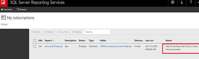

SSRS Subscription getting error. failure sending mail.

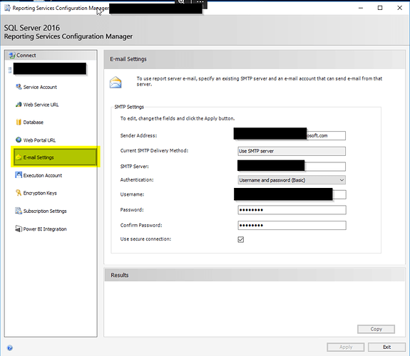

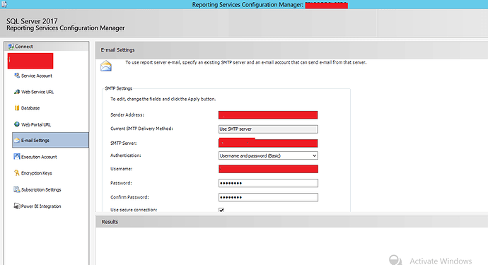

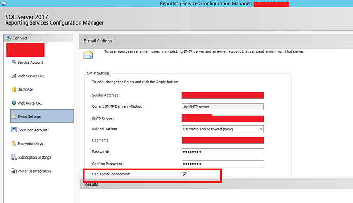

We need to untick Use secure connection it is not happening. Just now checked with Coligs, Need to untick the secure connection. Can you help with this
Your mail server probably requires a secure connection. You will have to setup an internal mail relay if you want to get around that. SMTP.
The “Use secure connection” check box appears(and is always checked), when the type is “Username and password”
Have you tried with Authentication: “No authentication” ??
Do you have email setup (and working) in the E10 App (in the Company Maintenance)??
Try those settings in Reporting Services Config Manager

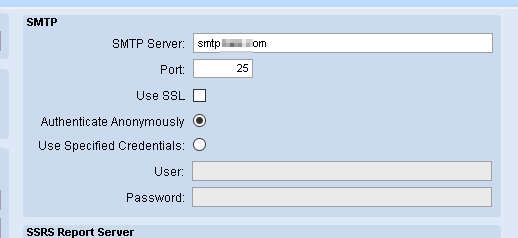

Same settings only having not working but not working in SSRS
@kylepbsps
ya you are correct, our internal email settings not requires secure connection is there. Same setup need to work .
