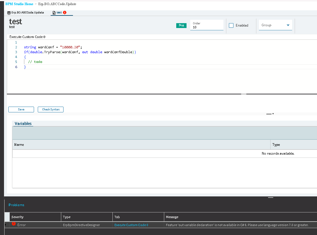

Feature 'out variable declaration' is not available in C# 6
Anybody know when bpms might come into the current age?
System.Drawing.Bitmap CS8059 Feature 'out variable declaration' is not available in C# 6. Please use language version 7.0 or greater.
It’s frustrating to be stuck with a version that was released 10 years ago, prevented from using so many current features that have been added. Yes I know I can use the bpm to call a function and the function will compile, but sometimes its like one line of code and its more code to call a function than to just do the thing in a bpm.

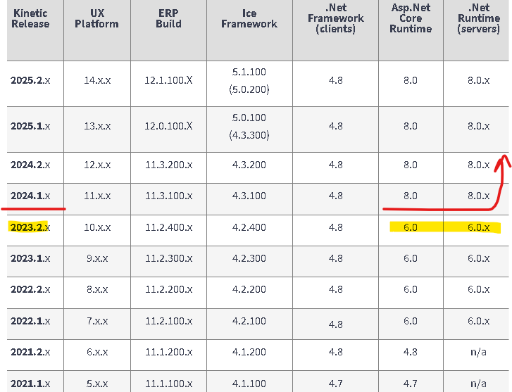

Well, I have tested the out variable decl in these 3 versions and it still gives the same error. They can’t bump .NET version to a non LTS (Long-Term Support), so we should expect to get .NET 8 support at a minimum on both, EFX and BPM (soon 10).
Kinetic 23.2, 24.2, 25.1
System.Drawing.Bitmap CS8059 Feature ‘out variable declaration’ is not available in C# 6. Please use language version 7.0 or greater.
Smart Client and Kinetic BPM Designer both complain.

Well, 2023.2 was still .NET 6 on server, so that error was expected. However,2024 onwards is NET 8.
The PowerTools are still “SmartClient”, probably still target .NET Framework 4.8. Haven’t checked.
I would assume power tools is just a minimal version of the smart client, not a rewrite to the latest version of .NET
Don’t need to assume, that is correct.
I ran into this same error today. I believe you need to define the variable wordConfDouble first, and then you can use it in the TryParse.
