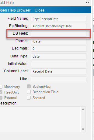

The APinvDtl form in AP Invoice Tracker shows in field help that the receiptdate field is called RcptReceiptDate and the EpiBinding is APinvDtl.RcptReceiptDate.

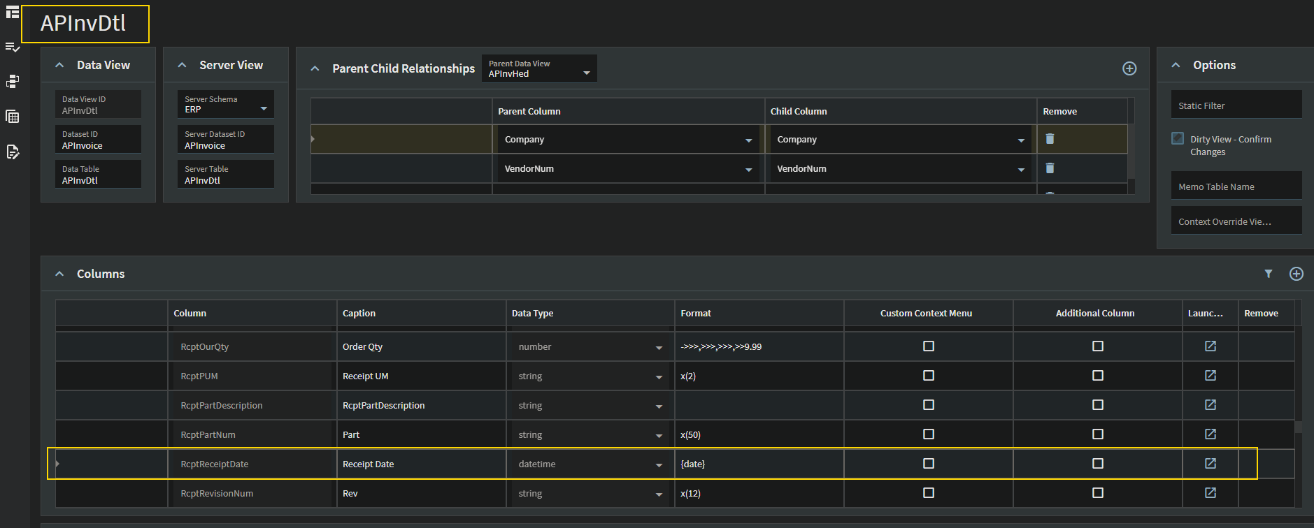

However, in Application Studio for AP Invoice Tracker, under Data Views, the field RcptReceiptDate is listed. As far as I can tell the source for this view is the Data Table APInvDtl.
Why this discrepancy?
I don’t know about this field in particular. Sometimes, Epicor has calculated fields on their data views on forms. If that is the case here, then it wouldn’t be in the table and therefore not available via a BAQ.
Definitely a calculated field
For the baq you are going to have to join the invoice details with the receipt details on company, invoice number and invoice line.
“Data Views” are exactly that, programmed queries that lookup and pull data into a tracker or entry forms from other tables.
As others have mentioned , DB Field is what tells you if the value is populating directly from the database table.field
