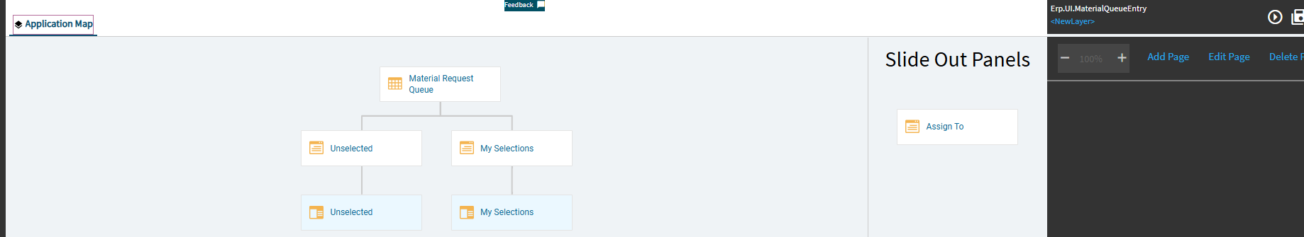

Select Material queue entry - Base from application studio

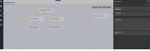

Save layer as ‘TestIssue’.

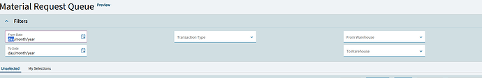

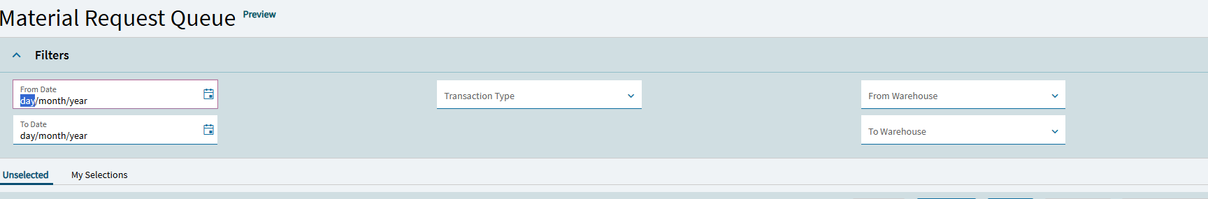

Preview - filters visible.

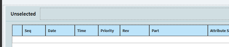

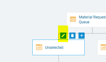

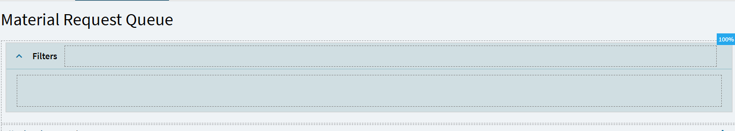

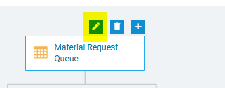

Click on unselected and edit
Grab Part and Move to right of revision

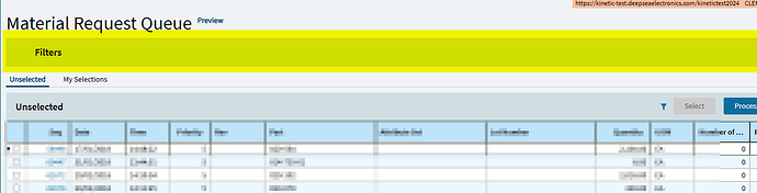

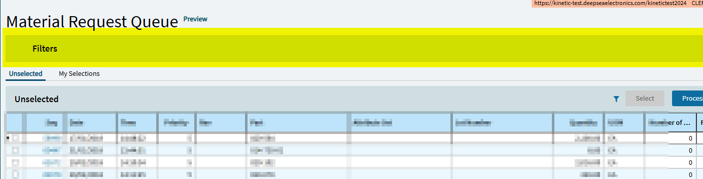

Preview and the filters have disappeared
All filter fields have been removed
Even just moving a field on the application page causes the same issue.
