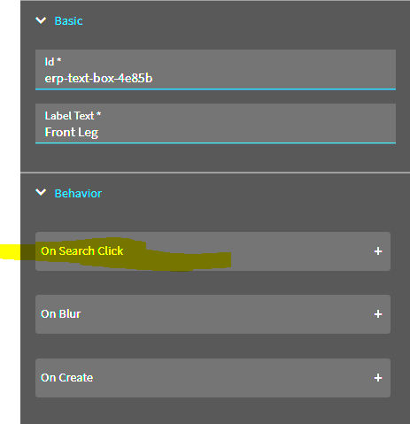

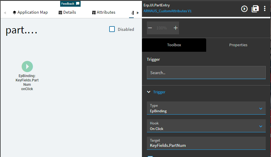

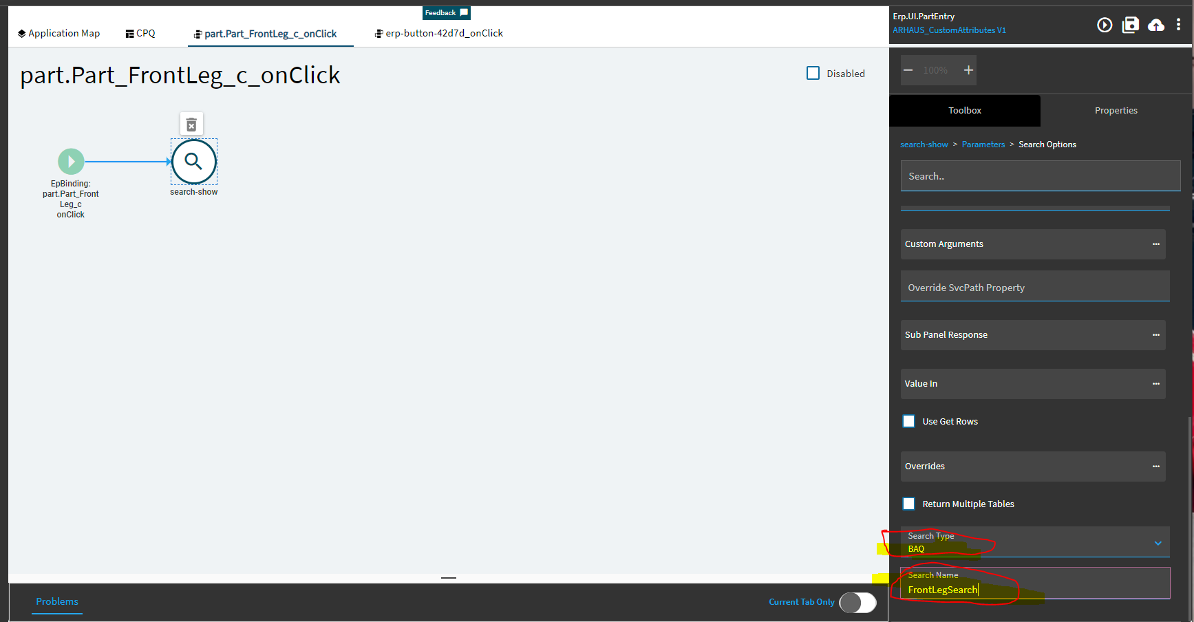

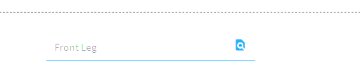

Hi David Thanks a lot for your answer i tried that and it dint do anything look at picture below i created my BAQ add the condition there and then addit to the event but it did nothing no search screen
Capitalize Part in your textbox epibinding.
