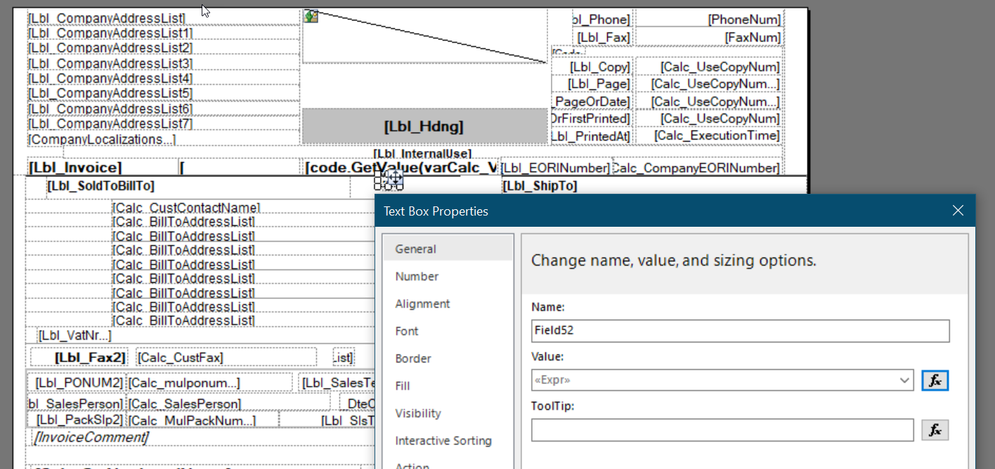

I successfully, thanks to the help of the people of this forum, pulled in CustID and attached it to ARForm invoice. But I am being asked to have it repeat on every page, as if it were part of the header. When I put it in the header, it works UNTIL accounts receivable goes to print a group of invoices. Then it just provides the first Customer ID on every page. The invoice number changes, but not the CustID.
How can I get it to repeat every page toward the top with the correct CustID corresponding to its proper invoice number? I don’t care if it’s in the header or in the table in the body, but it needs to be at least “header like”.

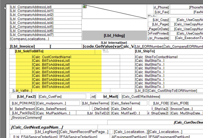

I’d be it into the SoldTo section
I thought about that, but if the invoice is longer than one page, my AR team wants to see it on top of that page too.

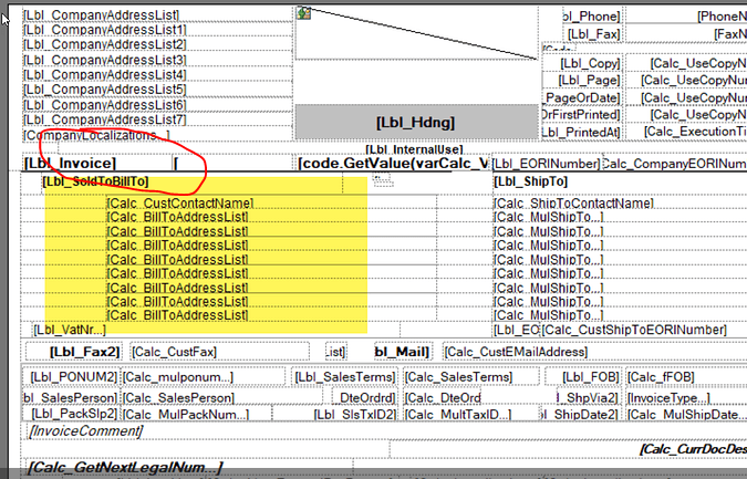

Like here with the invoice # repeating on each page:

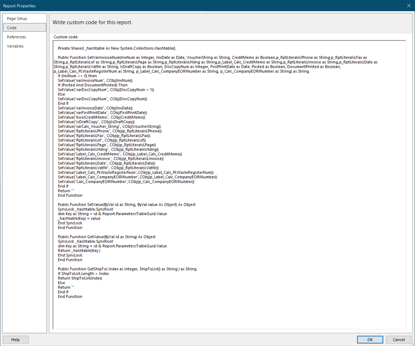

The field code is calling code in the Report Properties so you’ll need to make your own public functions. Also there is a hidden field setting the value that the “Get” pulls
