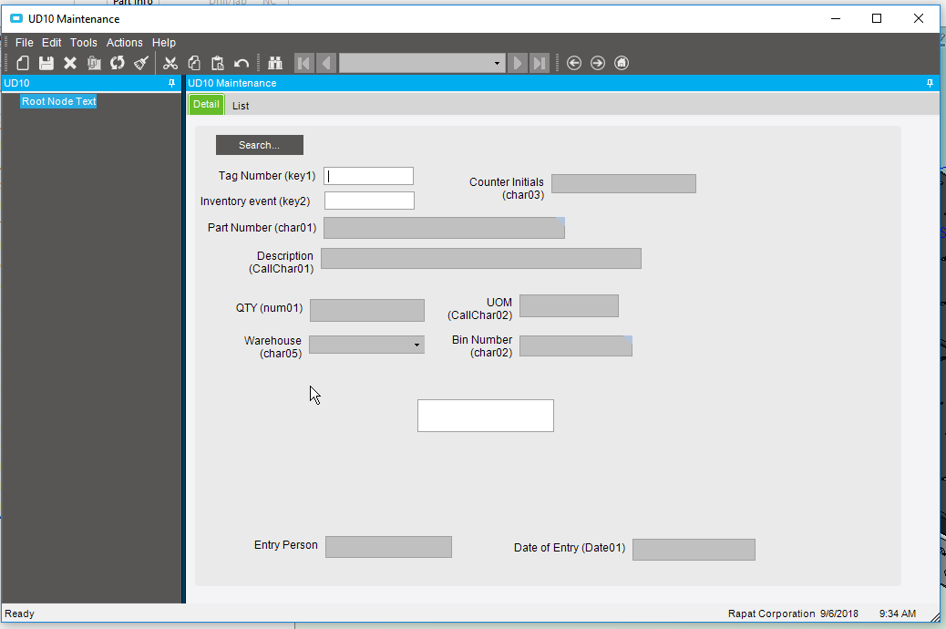

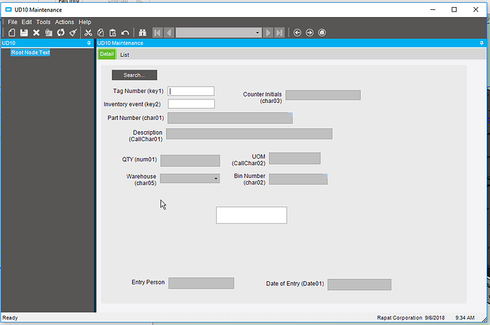

So new approach that I’m wondering about possibilities. The state that the screen is is when you have a freshly cleared screen would be exactly what I would want, except I want to keep the other items in the tree. Is it possible to trigger that state with a button so instead of new, or clear, I hit this a new button that triggers a “check if new” state that works just like the freshly cleared screen?
You can see below, the only fields available are the key fields, everything else is grayed out. When you put something into key1 and tab out, it either looks up the existing, or asks if you want to make a new record. Pretty much what I want, and I can’t get this to work the way I want it, will simply train the workers to use the clear screen instead of new, and they lose their history.

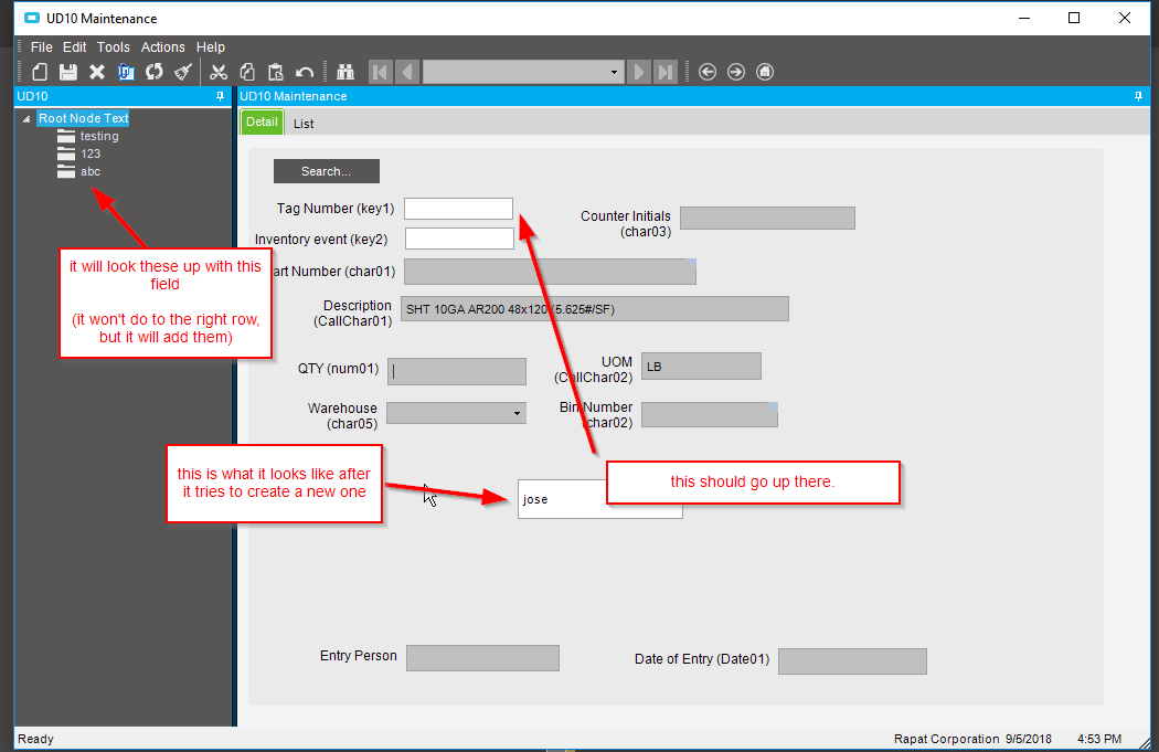

Second thing that I have going on.
This block of code is looking at the data view right? If we are merging the original adapter with the new one, we will have more that one row, so the get new is only going to work if there are no existing rows over there on the tree. So what we need to check for is whether or not the unbox box matches any of the key1’s in the data set right? If if matches, load that row, if it doesn’t make a new record. That’s what I think @Chris_Conn was getting at with iterating through the rows. So do that, is this a foreach loop? check for a match and if it finds one, load that row into the screen and if it doesn’t prompt for new?
