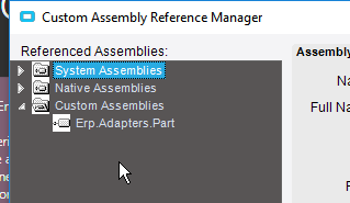

I’m guessing that I need to go into the custom assembly reference manager and add Erp.Adapters.Part right?

so Ice.Adapters; was already in there. But that would be for the UD tables right? I think I would also need Erp.Adapters for the part adapter since that is in the Erp section? I tried it without Erp, and it didn’t compile, with it did, so we’ll assume I need it. And we’ll assume my logic is correct as to why :wink:
