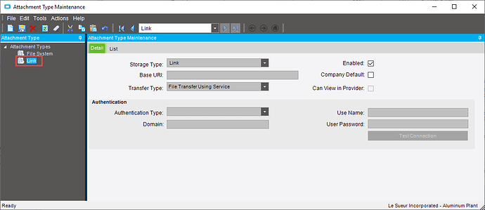

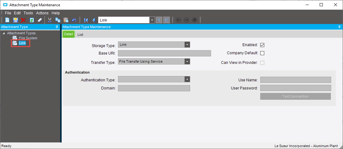

Here’s the solution in case someone else runs into this issue.
We had to add a ‘link’ record to Attachment Type Maintenance. Once we added that record and restarted the client(s) then attachments that were added before the update could be opened.

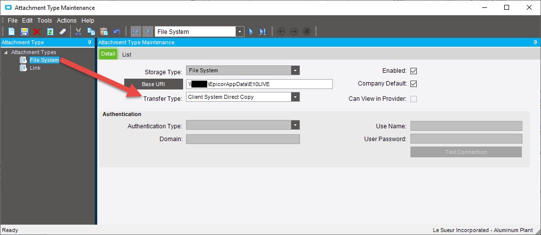

We also needed to change the transfer type from ‘File Transfer Using Service’ to ‘Client System Direct Copy’ for the ‘File System’ record in Attachment Type Maintenance, which is set as the company default.
