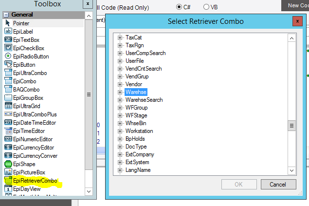

Instead of using an ultra combo and writing all that code, use an EpiRetriverCombo and select Wharehse and let the system do it for you.
so i use an epiretreivercombo. does that combobox will retrive all the info filtered by the value of the other combobox?

the retriever combo will return all the values in the WareHse table exactly the same way as the one in the base screen.
the retreiver shows every warehouse i just want to show the warehouses when warehse.plant = Combobox.value in this case i call that object with the guidid

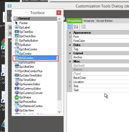

If you want to filter by Plant you can do it a couple of ways, but the easiest way to do it without writing any code is use an BAQCombo
The BAQ Combo runs a BAQ to pupulate the dropdown and you can use BAQ Markup Language to tell it what to filter by

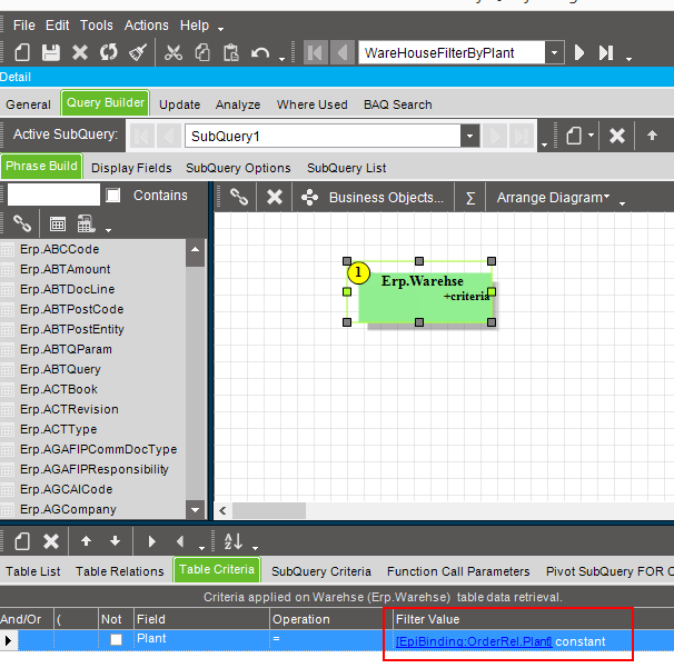

Simply write a BAQ that returns the WareHouseCode and Description then in the Filter in the BAQ Set the filter to
Plant = [EpiBinding:OrderRel.Plant] (or whatever dataview / value you are filtering for)
This tells the BAQ when bound to an BAQComobo or BAQVIew to filter by the view values at OrderRel.Plant found on the given data view.
If you don’t need to filter then you can use the retriever.
Find the BAQ attached that does this
WareHouseFilterByPlant.baq (10.8 KB)

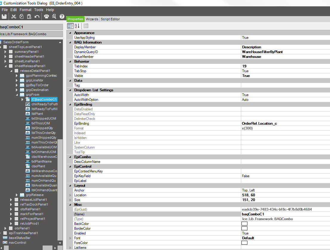

I am getting this error
Message: Key not found: ‘Description’
Parameter name: key
Program: Infragistics4.Shared.v12.2.dll
Method: GetItem
this is how i set the BAQCombobox is there anything i am doing wrong? please advise
never mid i got it thanks for the help really apreciated
