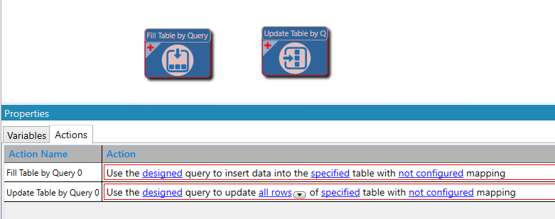

What are the differences between Fill table by query v Update table by query and are there scenarios where either should be used over the other.
I am using Update table by query but I see some users suggesting Fill table by query should be used.
Fill Table by Query should is used to insert new rows into a table. Update Table by Query will allow you to change values in existing rows of a table.
Thanks @danvoss - that’s how I interpret the 2 different widgets but a user on the forum put together a reaonably length document on why, even when updating a table, Fill table by query should always be used.
I just wanted to see how other users understood the functionality in case I was missing something.
