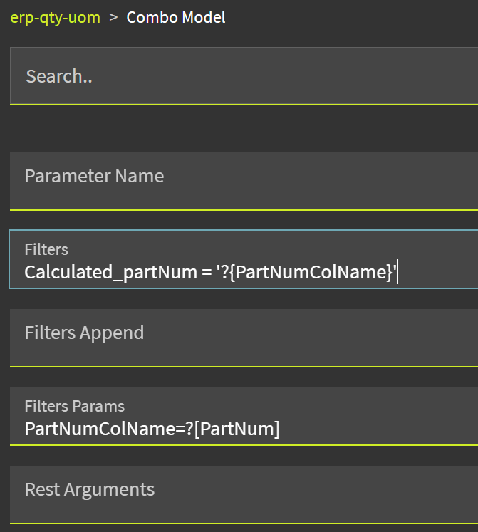

This is the current combo setting in App Studio:

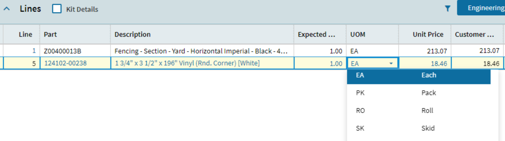

This is a partial list of UOM that currently displays in the combo box:
I would like to add a filter, so it only shows these two:

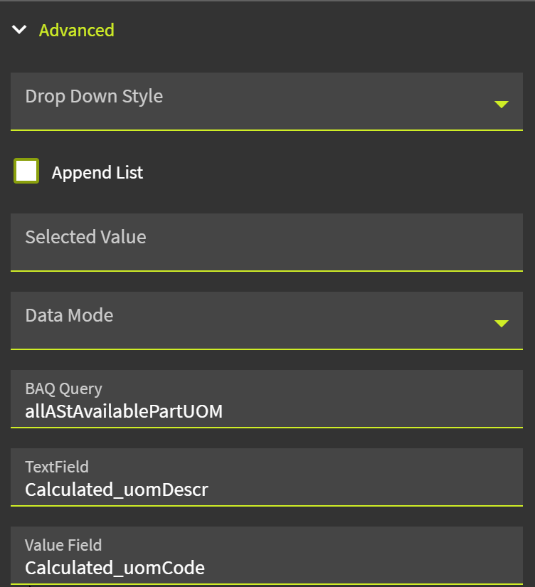

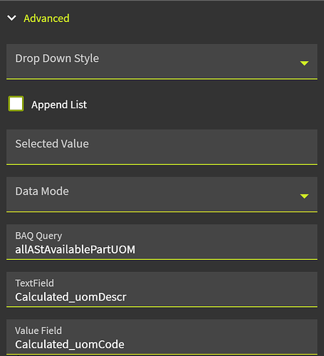

To work around this, I created a BAQ with the data I need and then updated the Combo Model (Sales Order Entry). Here are some snippets of the values I entered from my BAQ:
I liked the idea of adding a BPM so that I don’t have to update the layers, so let me know if there’s something I missed or another way to accomplish this.
