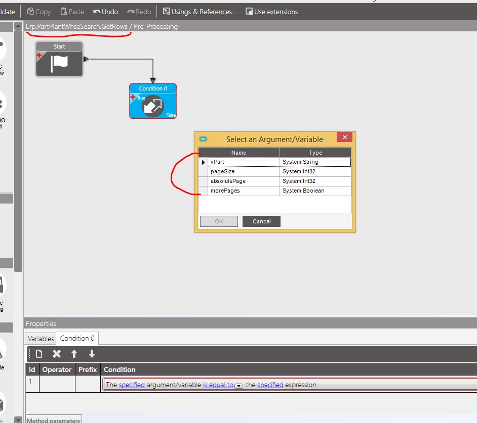

Hi guys,
this time i have a little problem, not urgent but i want to resolve it…
i have a Warehouse… that is assigned to a Part… this warehouse have all bins = Inactive, and when we do a “Direct Shipment” on “Transfer Order Shipment Entry”, this Warehouse appears on Warehouse List… how can i filter it? i’m dont worry if need to filter with code or description…
i see the trace for check what method is called:
<tracePacket>
<businessObject>Ice.Proxy.Lib.BOReaderImpl</businessObject>
<methodName>GetRows</methodName>
<parameters>
<parameter name="serviceNamespace" type="System.String"><![CDATA[Erp:BO:PartPlantWhseSearch]]></parameter>
<parameter name="whereClause" type="System.String"><![CDATA[14409]]></parameter>
<parameter name="columnList" type="System.String"><![CDATA[]]></parameter>
</parameters>
But when i try to implement solution like that…
Hello,
I was asked to add a bit flag to indicate an inactive ShipTo. I have created the UD field InActive_c in ShipTo table.
I added the checkbox into the CustomerEntry Form.
So far all is ok.
My goal was to not show the inactive shiptonum when user clicks on a shipTosearch button. I then created a BPM on ShipTo GetList. In the PostProcess I added the Set Argument widget. I then set the whereClause argument to “ttShipToListRow.UDField<System.Boolean>(‘Inactive_c’) = 0”
I checked inacti…

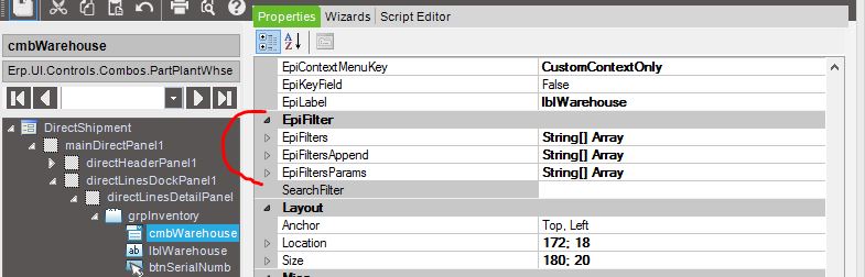

but when do i dont have the paramether “wereClause”
i tried too filtering on Customization of the form… but when do the all warehouses appears… (including the “inactive” warehouse).
any idea how can i resolve it?
