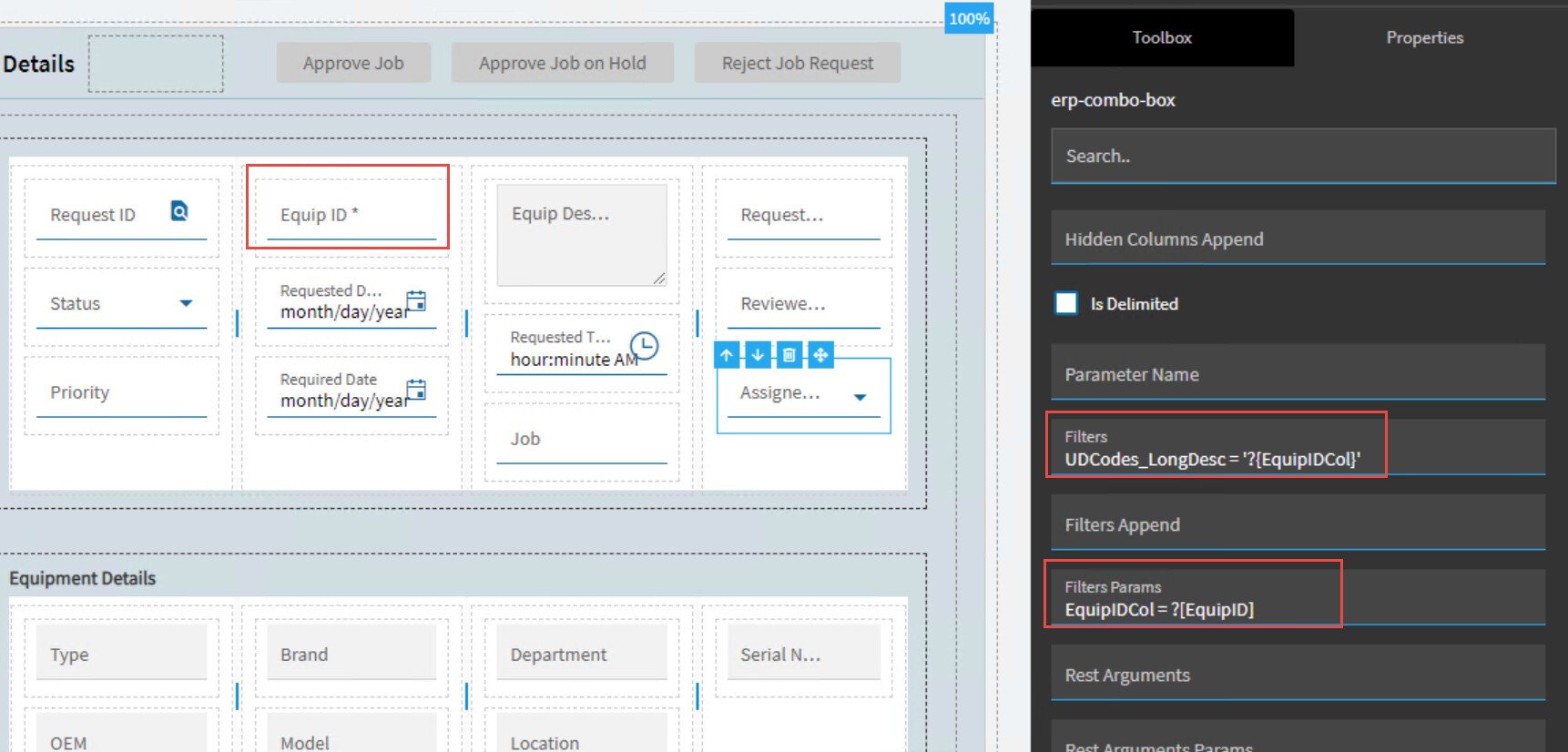

Filtering a BAQ Combo by a value on screen
I’m trying to use App Studio to customize a kinetic screen. I have a BAQ in a combo. The data populates ok. When I try to add a filter to the combo it still returns all the items. If I hardcode in the filter (UDCOdes_LongDesc = “IT”) it works and filters the dropdown. I want to filter the list by the Equipment ID on screen (Epi binding: MaintReqView.EquipID).
I’m not sure what I’m missing :frowning:

I think you need square brackets here… not curly.
