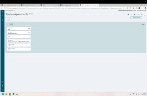

Screen Recording 2025-06-19 at 9.09.17 PM
Thanks for all the suggestions on using the UserCodes.UserCodesCombo approach. I was able to get the Reason combo to dynamically change its CodeType based on my UD_OrderStatus_c value and pull in all the CodeIDs under that type. However, it doesn’t support a second-level filter of those codes by another field’s value—so once the combo is loaded it still shows every reason for that CodeType, not only the ones valid for the current Status.
