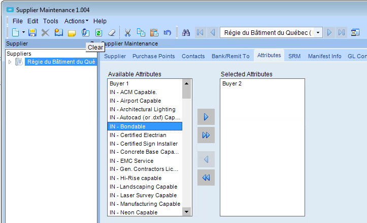

Maybe you could add the buyers as an attribute to the supplier that are restricted from purchasing from this supplier and then add a BPM that doesn’t let that buyer select that supplier in PO entry? Or you could do the same with a UD field.
