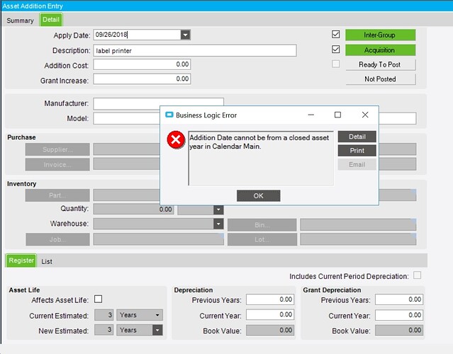

I found the option . but all the fiscal year is unchecked means it is not closed but i am facing error like::Addition Date cannot be from a closed asset year in Calendar Main.

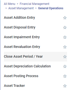

If you are working with Assets, you need to reopen the Asset Period\Year.
I have found Assets to be a bit messy.
I would advise whatever you are trying to do, you first do in your Test environment to make sure something weird doesn’t happen to your asset values.
