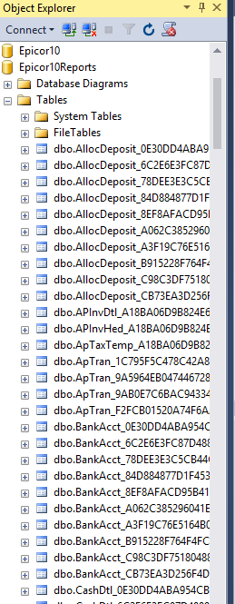

You’ll want to do something like this where you scan Information_Schema.Tables

Well, that just lists the tables … Which I can already see in SSMS.
By browsing the tables, I’ve found that it looks like a default table GUID is stored dbo.Catalog.Parameter

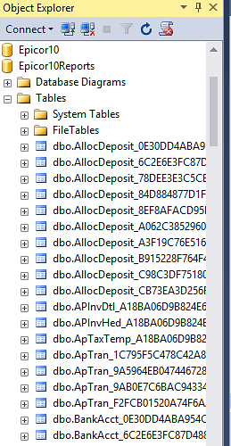

select name from Epicor10Reports.sys.tables where name like '%<GUID #>%'
“Epicor10Reports” appears to be a DB object name that you created. Generically speaking, what is it?
It is the database name where the Report tables are separate from the Epicor ERP and Ice tables.
