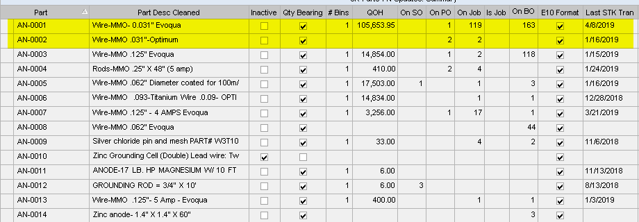

I ended up making a BAQ and dashboard that that showed the references to the P/N. Basically, just counted the Orders, Jobs, BOMs, etc… that the P/N was referenced by.
Take the first two rows of the following screen shot
P/N AN-0001:
  • Is Qty Bearing
  • Currently in 1 Bin
  • QOH is 105,653 FT
  • Not referenced on any SO
  • Is referenced on 1 PO
  • (on Job) Is a Material of 119 Jobs
  • (is Job) Is NOT the part being produced by any job
  • Is referenced by 163 BOMs
P/N AN-0002
  • is only referenced by 2 PO’s and on 2 Jobs

Here are some notes:
  • Pretty sure it is free from any UD fields.
  • Dashboard Fields (the non-obvious ones)
    • #Bins - The count of PartBins with non-zero QOH for the Part
    • QOH - Sum of OnHandQty in all bins, across all warehouses and sites.
    • On SO - Number of times referenced on open Order lines
    • On PO - Number of times referenced on open PO lines
    • On Job - Number of times referenced as a material on open jobs
    • Is Job - Number of times referenced as the part being made by an open job
    • E10 Format - A flag (calc field) to indocate the part number matches our new format of SS-NNNN.
    • New P/N - Is the field Part.UserChar1. Which holds the P/N that ā€œoldā€ P/N’s are being replaced with
    • Last STK Tran - The most recent PartTran record with type %STK%
    • On BOM - Number of times referenced as a material on BOMs
    • Type, IUM, PUM, UOMClassID - all pretty obvious
    • Cost Diff - A Boolean calc to show if there is a diff between the PartCost of the ā€œoldā€ P/N and the new. Only true if PartCost exists for the ā€œoldā€ P/N (from UserChar1) and this P/N.
    • Run Out - the Runout flag in the part Master
  • The Tracker/Filter fields are pretty self explanatory.
  • Has Demand - Will show records with at at least one of: ā€˜On SO’, ā€˜On PO’, ā€˜On Job’, or ā€˜Is Job’.
  • Alt Part Count is for filtering parts that have an Alternate assigned inPart Master
  • Booleans with ā€œ(YNB)ā€ can use B (or leave blank) to find both True and False records
