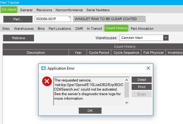

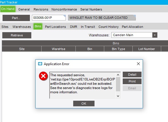

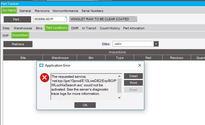

Second - what different ways do I have to track what all bins a part exists in? I have tried Part Tracker but every single time I hit ANY of the retrieve buttons I get an exception. (see 3 screenshots)

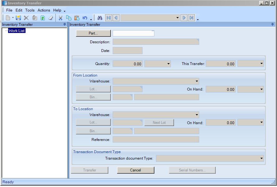

Inventory Transfer is the best way to move Parts around
Material Management -> Inventory Transfer
That exception you should call support on, that shouldn’t be happening… Go look in you Server Logs Event Viewer and see what the actual error is
Thanks guys. I will forward this on to the IT team. Unfortunately, I don’t even have access to the BPM source folder on the server - which wouldn’t be a huge issue if my IT were more responsive :frowning:
BTW - Step 1 of any troubleshooting procedure seemed to solve it: Reboot the server lol
