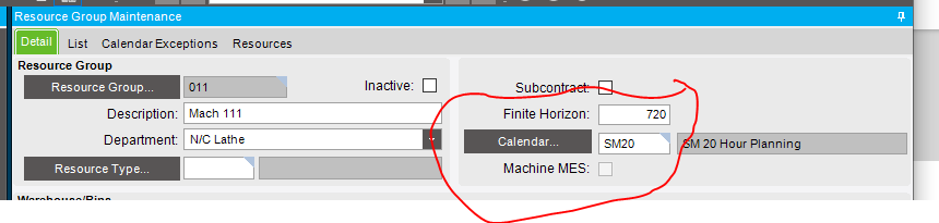

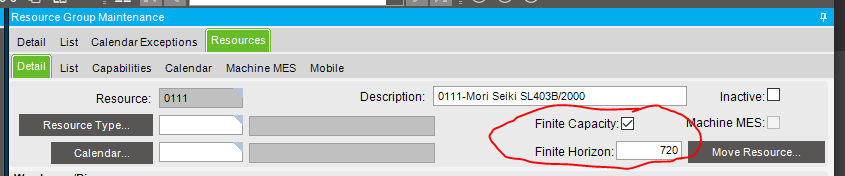

I would check the finite horizon on the resource, on the resource group, and in Site Maintenance (or whatever that is called these days).
Also make sure the “Finite” checkbox is selected.
Yes I made sure both the resource and the resource group had the finite horizon and calendars set up correctly
