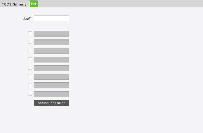

So I was able to create a form that works. You enter the Job#, the assemblies load, you check the
box next to the ones you want to add FAI to, and click a button. It will then go and add a FAI qty of 1 to each operation under that assembly for that job. Is this what you were looking for? If so, I am trying to think of the best way that I can get that to you. I can potentially email you the exported customization, then have you load it in? we will have to figure that out.

Here is the example I created to see if I could get it to work. You enter the job#, and hit tab. It will then load all assemblies. You check the box next to the ones you want to add an FAI quantity to, and it will add an FAI qty of 1 to each operation with in that assembly.
This is my code below for the above form. You would have to create the form (Or use the code I provided as a guideline). In order to get this to work, you will have to load the jobentry adapter. you do this by going to tools>Assembly Reference Manager>Add Custom Reference then change the file type to all, and select “Erp.Adapters.JobEntry”,“Erp.Contracts.BO.JobEntry”,“ERP.UI.JobEntry”
I hope this helps. I know it is not as ideal as handing you a txt file, but, if you learn how to do this, and what it means, you can create a whole lot of customizations!

					editRow["FAQty"] = 1;
					editRow.EndEdit();
					adapterJobEntry.Update();
					i=i+1;
			if (this.epiCheckBox2.Checked)
				string text = this.epiTextBox3.Text;
				string[] asm3text = text.Split(separators, StringSplitOptions.RemoveEmptyEntries);
				string asm3 = asm3text[0];
				adapterJobEntry.GetDatasetForTree(this.epiTextBoxC2.Text, Convert.ToInt32(asm3), Convert.ToInt32(asm3), true);
				EpiDataView edvPA3 = new EpiDataView();
				edvPA3.dataView = new DataView(adapterJobEntry.JobEntryData.JobOper);
				i = 0;
				x = adapterJobEntry.JobEntryData.JobOper.Rows.Count;
				while (i<x)
					DataRow editRow = adapterJobEntry.JobEntryData.JobOper.Rows[i];
					editRow.BeginEdit();
					editRow.EndEdit();
					i=i+1;
			if (this.epiCheckBox4.Checked)
				string text = this.epiTextBox4.Text;
				string[] asm4text = text.Split(separators, StringSplitOptions.RemoveEmptyEntries);
				string asm4 = asm4text[0];
				adapterJobEntry.GetDatasetForTree(this.epiTextBoxC2.Text, Convert.ToInt32(asm4), Convert.ToInt32(asm4), true);
				EpiDataView edvPA4 = new EpiDataView();
				edvPA4.dataView = new DataView(adapterJobEntry.JobEntryData.JobOper);
				i = 0;
				while (i<x)
					editRow.EndEdit();
					i=i+1;
			if (this.epiCheckBox6.Checked)
				string text = this.epiTextBox5.Text;
				string[] asm5text = text.Split(separators, StringSplitOptions.RemoveEmptyEntries);
				string asm5 = asm5text[0];
				adapterJobEntry.GetDatasetForTree(this.epiTextBoxC2.Text, Convert.ToInt32(asm5), Convert.ToInt32(asm5), true);
				EpiDataView edvPA5 = new EpiDataView();
				edvPA5.dataView = new DataView(adapterJobEntry.JobEntryData.JobOper);
				i = 0;
				while (i<x)
					editRow.EndEdit();
					i=i+1;
			if (this.epiCheckBox8.Checked)
				string text = this.epiTextBox6.Text;
				string[] asm6text = text.Split(separators, StringSplitOptions.RemoveEmptyEntries);
				string asm6 = asm6text[0];
				adapterJobEntry.GetDatasetForTree(this.epiTextBoxC2.Text, Convert.ToInt32(asm6), Convert.ToInt32(asm6), true);
				EpiDataView edvPA6 = new EpiDataView();
				edvPA6.dataView = new DataView(adapterJobEntry.JobEntryData.JobOper);
				i = 0;
				while (i<x)
					editRow.EndEdit();
					i=i+1;
			if (this.epiCheckBox10.Checked)
				string text = this.epiTextBox7.Text;
				string[] asm7text = text.Split(separators, StringSplitOptions.RemoveEmptyEntries);
				string asm7 = asm7text[0];
				adapterJobEntry.GetDatasetForTree(this.epiTextBoxC2.Text, Convert.ToInt32(asm7), Convert.ToInt32(asm7), true);
				EpiDataView edvPA7 = new EpiDataView();
				edvPA7.dataView = new DataView(adapterJobEntry.JobEntryData.JobOper);
				i = 0;
				while (i<x)
					editRow.EndEdit();
					i=i+1;
			if (this.epiCheckBox12.Checked)
				string text = this.epiTextBox8.Text;
				string[] asm8text = text.Split(separators, StringSplitOptions.RemoveEmptyEntries);
				string asm8 = asm8text[0];
				adapterJobEntry.GetDatasetForTree(this.epiTextBoxC2.Text, Convert.ToInt32(asm8), Convert.ToInt32(asm8), true);
				EpiDataView edvPA8 = new EpiDataView();
				edvPA8.dataView = new DataView(adapterJobEntry.JobEntryData.JobOper);
				i = 0;
				while (i<x)
					editRow.EndEdit();
					i=i+1;
		//Tells you it has been completed, and it clears the form
		MessageBox.Show("FAI Quantities have been added!");
		load();
		} catch (System.Exception ex)
			ExceptionBox.Show(ex);
	private void load()
		this.epiCheckBoxC1.Checked = false;
		this.epiCheckBox1.Checked = false;
		this.epiCheckBox2.Checked = false;
		this.epiCheckBox4.Checked = false;
		this.epiCheckBox6.Checked = false;
		this.epiCheckBox8.Checked = false;
		this.epiCheckBox10.Checked = false;
		this.epiCheckBox12.Checked = false;
		this.epiTextBox1.Text = "";
		this.epiTextBox2.Text = "";
		this.epiTextBox3.Text = "";
		this.epiTextBox4.Text = "";
		this.epiTextBox5.Text = "";
		this.epiTextBox6.Text = "";
		this.epiTextBox7.Text = "";
		this.epiTextBox8.Text = "";
		this.epiTextBox1.Value = "";
		this.epiTextBox2.Value = "";
		this.epiTextBox3.Value = "";
		this.epiTextBox4.Value = "";
		this.epiTextBox5.Value = "";
		this.epiTextBox6.Value = "";
		this.epiTextBox7.Value = "";
		this.epiTextBox8.Value = "";
		this.epiCheckBoxC1.Enabled = false;
		this.epiCheckBox1.Enabled = false;
		this.epiCheckBox2.Enabled = false;
		this.epiCheckBox4.Enabled = false;
		this.epiCheckBox6.Enabled = false;
		this.epiCheckBox8.Enabled = false;
		this.epiCheckBox10.Enabled = false;
		this.epiCheckBox12.Enabled = false;
		this.epiTextBox1.ReadOnly = true;
		this.epiTextBox2.ReadOnly = true;
		this.epiTextBox3.ReadOnly = true;
		this.epiTextBox4.ReadOnly = true;
		this.epiTextBox5.ReadOnly = true;
		this.epiTextBox6.ReadOnly = true;
		this.epiTextBox7.ReadOnly = true;
		this.epiTextBox8.ReadOnly = true;
		this.epiTextBoxC2.Text = "";
		this.epiTextBoxC2.Value = "";
Nick that looks great. Thank you so much for sharing.
