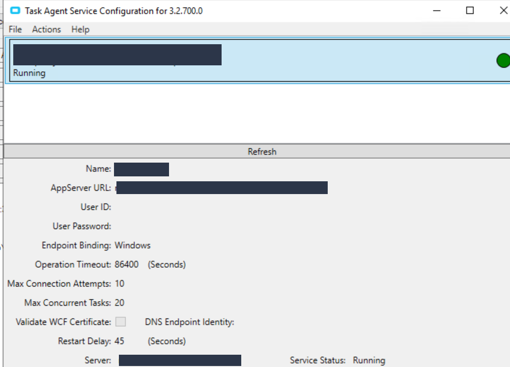

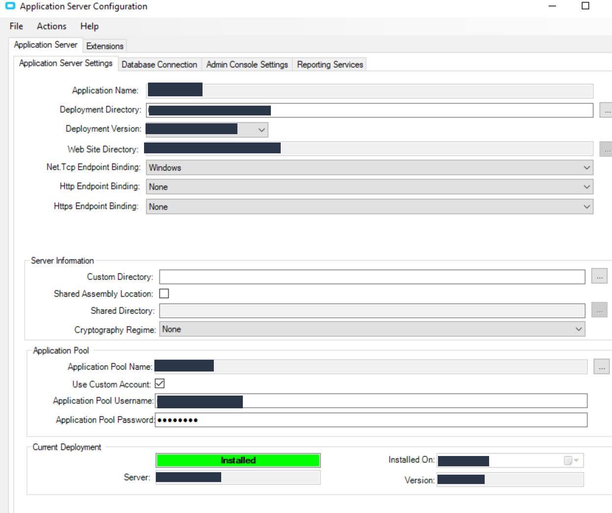

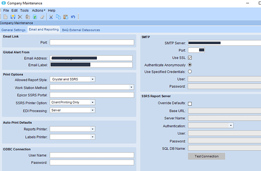

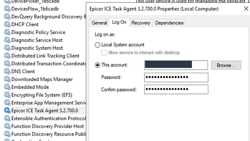

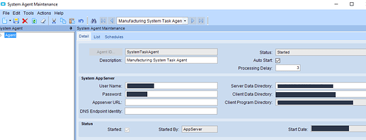

Anyways, here are the relevant setup screens that could provide some clues into what’s gone wrong in your system:
Thanks so much for the comprehensive response, Tom. I went through all the screenshots, and didn’t see anything that was seriously wrong. I will say that the error only shows up in the System Monitor when the email is being triggered from my BPM, so it has to be something I overlooked there.
