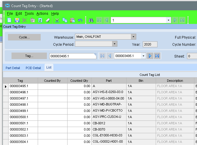

I you can select multiple tags at once (use the Tag… button to launch the search and then select multiple tags). Then use the List sheet to show it as a grid. You’ll need to drag the “Counted By” and “Counted Qty” columns over to the left side, like:
If you had the tags in order, just
Select the “Counted By” field
Enter the counter’s initials
Hit the tab key to jump to the “Counted Qty” field
Hit the Down Arrow to save that entry , and go to the next record (tag) below it.
Hit the left Arrow to get back to the “Counted By” field
Rinse and Repeat

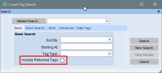

P.S. To load already entered tags, you need to check the box in the search form

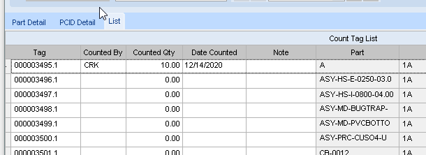

P.P.S. - You might want to drag the “Counted Date” and “Note” columns over too.
