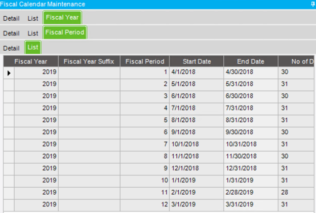

Hello Everyone,
I need to know that Is there fiscal year change impact on the system ? Here is the situation below:-
• We changed our fiscal year end from 3/31/2019 To 12/31/2019
• Currently, November 2019 is in Year 2020 because the system has taken out fiscal year is 3/31/2020 and November is Period is 8 then December will be 9. Rest of calendar year 2019 is fine. But, on January 2020 we need our Year to be 2020 and the period to be 1.
• When we want to process a year end to January. Obviously, all our P&L account should zero to retained earnings.
our 2019 calendar below
Our 2020 calendar below

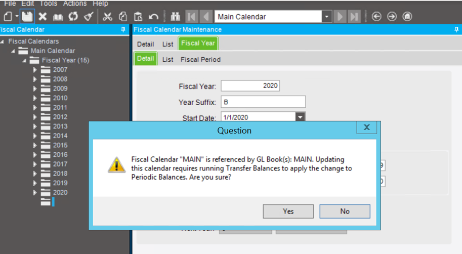

Thank you Calvin,
i)Created 2020/B - On Test Instance
ii) Just testing the parameter on the General Ledger Report
Note: Transfer Opening Balance to Next Year and Verify Balances are not processed yet. I assume if I run these then then its fine but not sure.
Did you create the FP’s for FY 2020B (in the second screen shot)? And change the Number of periods in 2020B to 1 for your test.
Or leave it at 12, change end date to 12/31/2020, and create 12 FPs

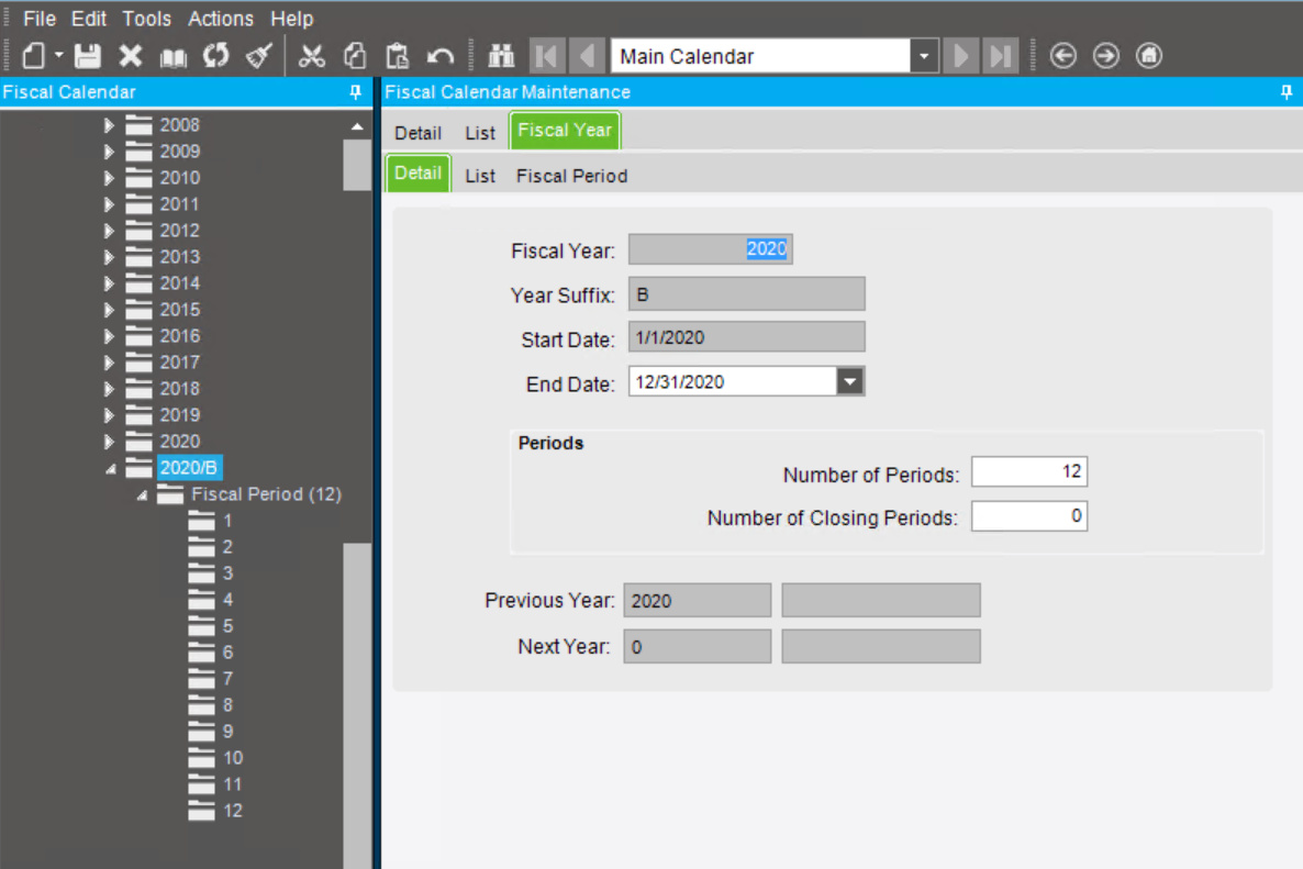

Excellent, after created 12 Periods for FY 2020B. I’m not getting any error on the report.
i) Entered the parameter again on the General Ledger report - No Error like before
ii) System Monitor
I think this solution will workout but we should not forget to put the suffix ‘B’ to view the report for FY2020. I have do transfer balance/year end check and see the retain earnings.
FTR - I’m just guessing at this.
Not sure how it might affect things like Financial reports. If you look in the FY setup, there are fields for Previous and Next Year. Since 2020 is the previous year to 2020/B, comparing prior year’s period might not lineup like you think.
For example,
  • Period 1 of FY 2020/B is Calendar January 2020.
  • Period 1 of FY 2020 is Calendar April 2019
